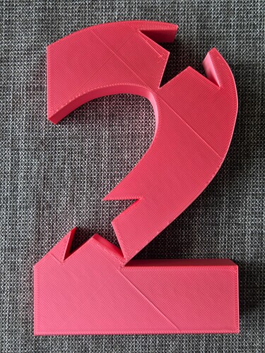

Lines seen on top of silk pla print
  • Printer model used
  • Slicer settings used
  • Type of filament used
Do you know what causes these prominent lines on top of silk pla print?
On bamboo slicer, the top surface looked smooth.
Do you have ironing activated at all?

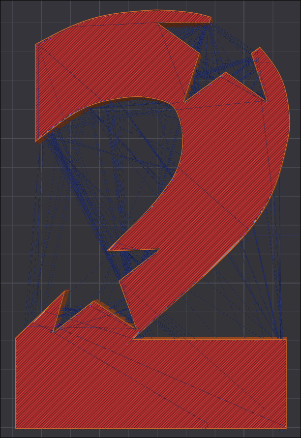

In general you probably will see lines with a print of this shape when using the monotonic top surface pattern. On awkward shapes it’s just the way the slicer generates it, the lines are produces when if comes back to fill in the rest (see below). Maybe trying concentric or one of the other patterns may work better?
Slice the file, then in the preview, click the toggle next to Travel to visualize the line type. If you see a big blue travel that matches where that line is, try removing the setting “reduce infill retraction". It’ll force it to retract for that travel and leave it cleaner.

Didn’t have ironing turned on.
The Travel lines are a little different than what actually showed:
The line defects feels slightly raised, but subtle.
Will try concentric next time. Would arachne wall generator help?
