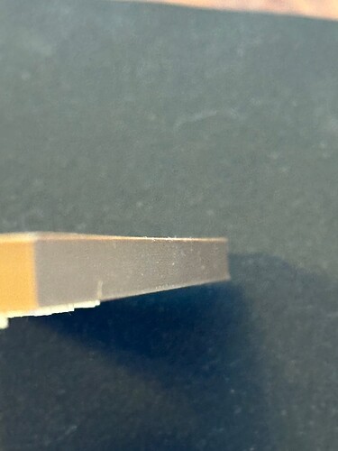

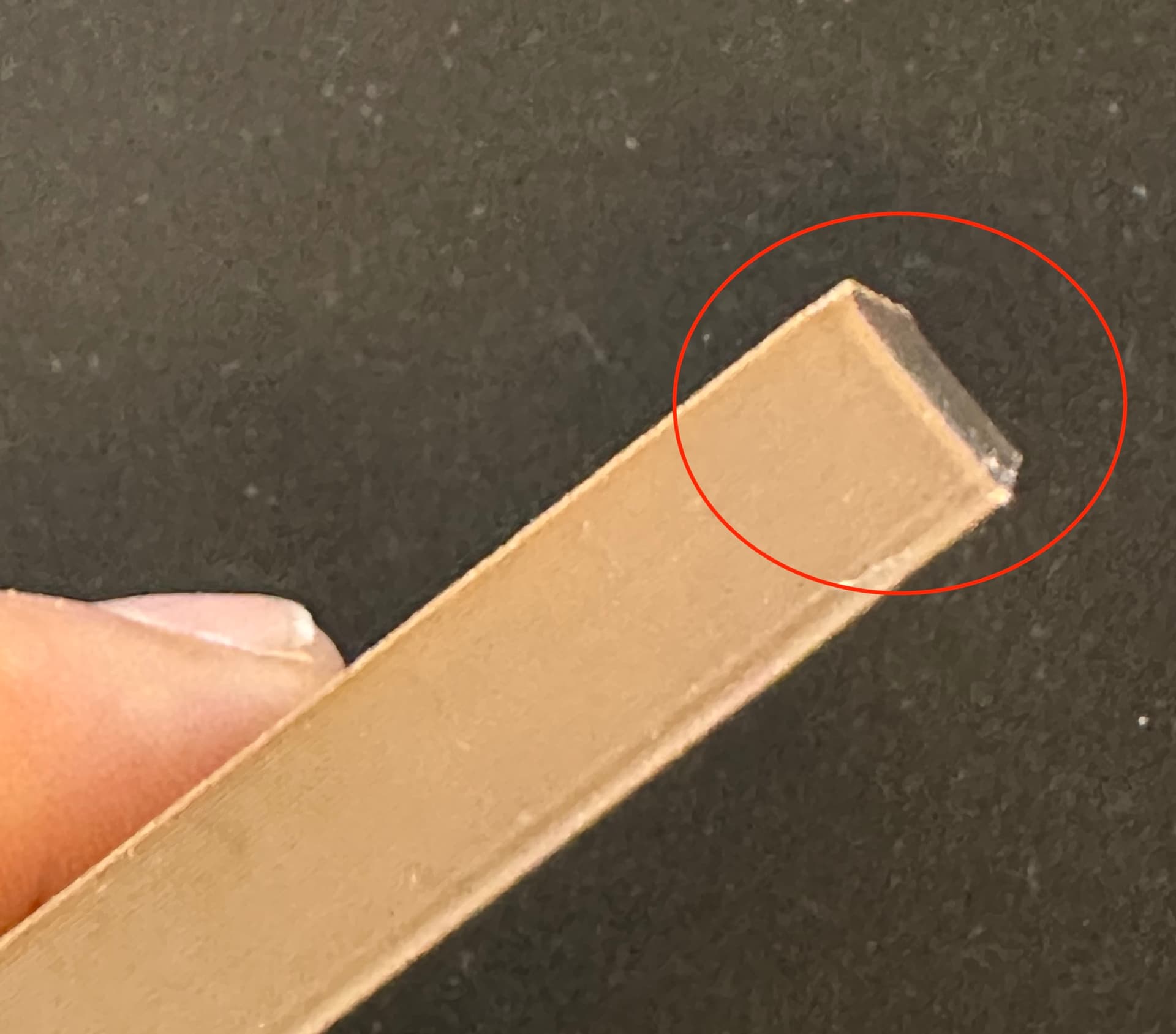

Some more photos of the problem. It’s very hard to get a good picture of what’s happening, but essentially the sides are straight except for the top and bottom layers which stick out about 0.2mm.
After a great deal of experimentation and troubleshooting, I managed to fix it by:
  • Lowering the bed temperature from 65C (default) to 55C. This fixed about half of the problem but didn’t make it go away.
  • Quadrupling elephant foot compensation from 0.075mm to 0.30. This fixed the remainder of the problem.
I still don’t know why it suddenly started doing this or whether it will continue to be a problem. I don’t want to have to remember to increase the elephant foot compensation every time I use my A1 printer. (Note that this only affects my A1 printer, not my P1S. The problem does not occur if I print the same 3D model with the exact same roll of filament on my P1S.)
