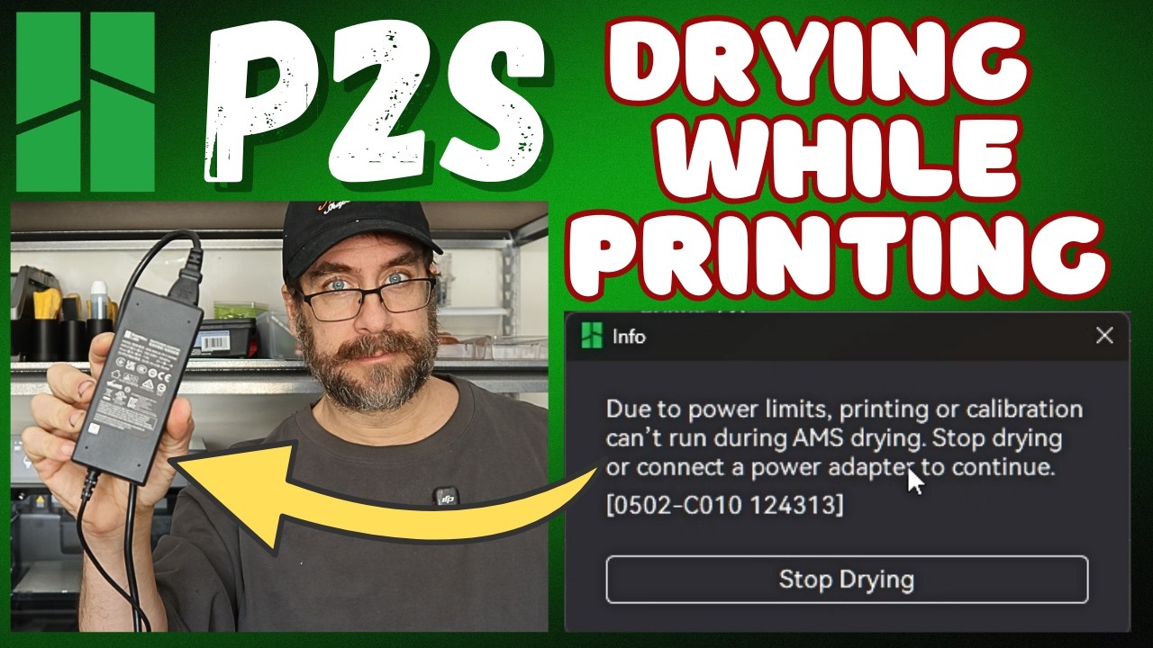

I discovered this morning that a 2 color print stopped before it started printing because I was drying in my A. AMS (white spool), and wanting to do a color (Yellow) from my B. AMS
Since A. AMS was drying. it wouldn’t start the print because the printer won’t print if drying is on. So I simply stopped the drying, and forged ahead.

Are you using the external power supplies for your AMS 2 units?
Oh yes. I didn’t want to strain my printer. Actually, I got a power brick for my original AMS2 before I ever got the second one.
So each has it’s own 24V supply. Do you know if there is a setting that could bypass that feature? (The can’t print if drying filament “Feature”)
