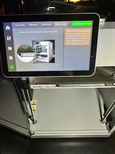

I am getting this error every second print when using the new Gold color BBL PEI plate on the XIC. I have check and rechecked the build plate position to make sure it is correctly placed. I DO NOT get this error even once on the regular BBL black textured PEI plate or High Temp.Cool plate. Not sure what it could be related to besides the paint or something on these new sheets.
I ignore the error and the prints are fine - no issues there. Anyone else facing this (note: made sure camera lens etc are clean too)
Image attached.
I get this “often”. Seems to be less if i make sure that the plate til more aligned to the right closer to the “Calibration Board” text.

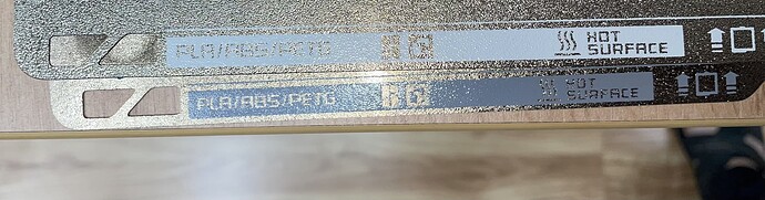

Maybe try printing a new tag and placing it on the plate? here is how to do it. Printables
I think they haven’t updated the QRcode for the new plate for the X1 series
This seems to work “most” of the times but still a hit or miss. No print issues though once I ignore it. Right edge.
Not a systematic fault but yes i have less warnings if its more to the right. Do you have the internal light on? Can try do document when it happens. But as you say the prints are good anyhow by just ignoring the message.
I get this everytime I use it, not seeing any difference when slightly to right or left. Have noticed there is a slight bit of movement between left and right positions vs the cool plates.

Since latest firmware update the error is no longer there, so seems to be resolved.

My X1C is in a very dark room (basement), the lighting for the build plate is turned on (no modifications to it, stock lighting).
What firmware are you running? I had that same issue but has stopped since the latest update.
Update: After the upgrade to version 1.06 on the X1 , the problem is “less frequent” but not completely gone. I would get this error most every second print earlier and now its like one in five or six plates that I get the error. As stated before there is no issue with the prints once I ignore the error.

As most of you have already noticed, there seems to be a minor size difference in this plate that makes it a little harder to “perfectly” align.

First one (white background for QR code) is from P1S. Second (darker background) is bought from store directly (in recent days).
First one gives me trouble in X1C with localization marker error, second just works.
Chamber light is on in both cases.
The “gold” colour of plate is also a bit different.
