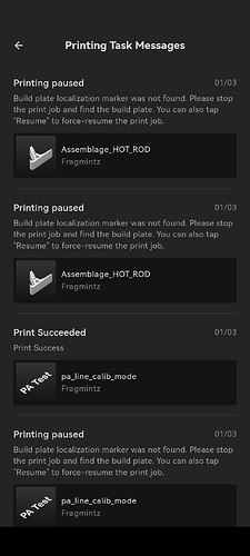

Localized marker?
Ok… not new to 3d printing…
But this X1C is driving me crazy…
  1. I get the " localized marker" issue every single time…
  2. Out of 20 attempted prints… Only 10 actually printed… multiple spaghetti failures, first layer issues.
    I’m printing ABS, generic and… I’ve done all the calibration, k value, p value…all that…
I’m almost to a point where I’m thinking about just giving it away…
So…I’m asking for help
Printing ABS has fogged the camera.
Agree with krellboy, the printer uses the camera to scan for the qr code on the build plate, and the camera lens is either dirty or the camera is not working properly. though I think it’s the camera, not the lidar, that is the issue.
edit I assume your printer’s firmware is updated, I remember ages ago there were additional problem with that.
