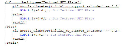

Some examples:
Embedded if statements that control Z offset based on build plate type and nozzle diameter:
Using filament type, chamber temp, and nozzle diameter to set up the correct air filtration modes:
I’m just saying that the functionality is all there to consolidate start/end/etc gcode and use conditionals to run the correct code based on machine.

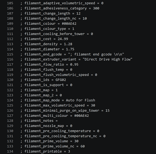

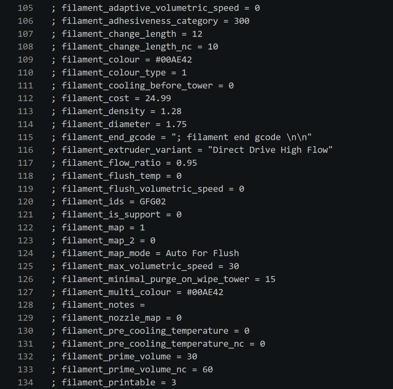

Here’s some additional context - not to contradict or confirm anything, but simply to provide a neutral perspective for putting things into perspective:
You wouldn’t have needed to open the G-code file, as it’s also specified in Bambu Studio. This G-code is inserted as a start code depending on the printer type:
That’s where all the IF conditions are located, such as controlling time-lapses, turning lights on and off, controlling chamber temperatures, and so on. That’s basically what’s placed before the actual G-code, and at the end because every machine is different.
But be careful: The filament / position information is not stored here! These are hard-coded in: CONFIG_BLOCK_START
That’s why it’s true that there are variables / conditionals, but these are defined in the printer’s specific start and end code within the Bambu Studio slicer. The filament / position, on the other hand, is hard-coded.
So yes, APEX86, as you say, there are variables / conditionals, but in a different context: specific startup / end code. Filament, etc., are hard-coded. That’s why this is not possible:
