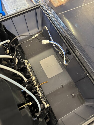

Found it is much easier to reassemble if you stand behind the lid of the AMS, i.e. from the rear. Your hand fits into the gap much more easily and you can see what you’re doing at the same time.
Prior to someone identifying the connectors with certainty (and because most of the likely male JST connectors I found were intended for surface-mount), I just cut the 2-wire power cable and the 5-wire RS485 cable and soldered in 22-inches of additional length. (That seems like a lot, but it’s great as I can lay the entire tray outside and next to the AMS housing when I connect the cables to the back of the AMS completely unimpede.) The AMS ribbon cables are #28, so I got a 5-ft ,6-wire #26 ribbon cable for about $6 from Amazon. Arrived the next day, quick soldering, and done. [FYI, BL support severely warned about violating the AMS warranty, but it had expired anyway.]
I was thinking the exact same thing about the longer cables or adding extensions.
BUT
It would probably make life 1000% easier if they made the bottom of the AMS removable. You would then have access to the tubes, first stage feeder screws, internal hub and all the parts within without having to remove the the wiring to start with.
