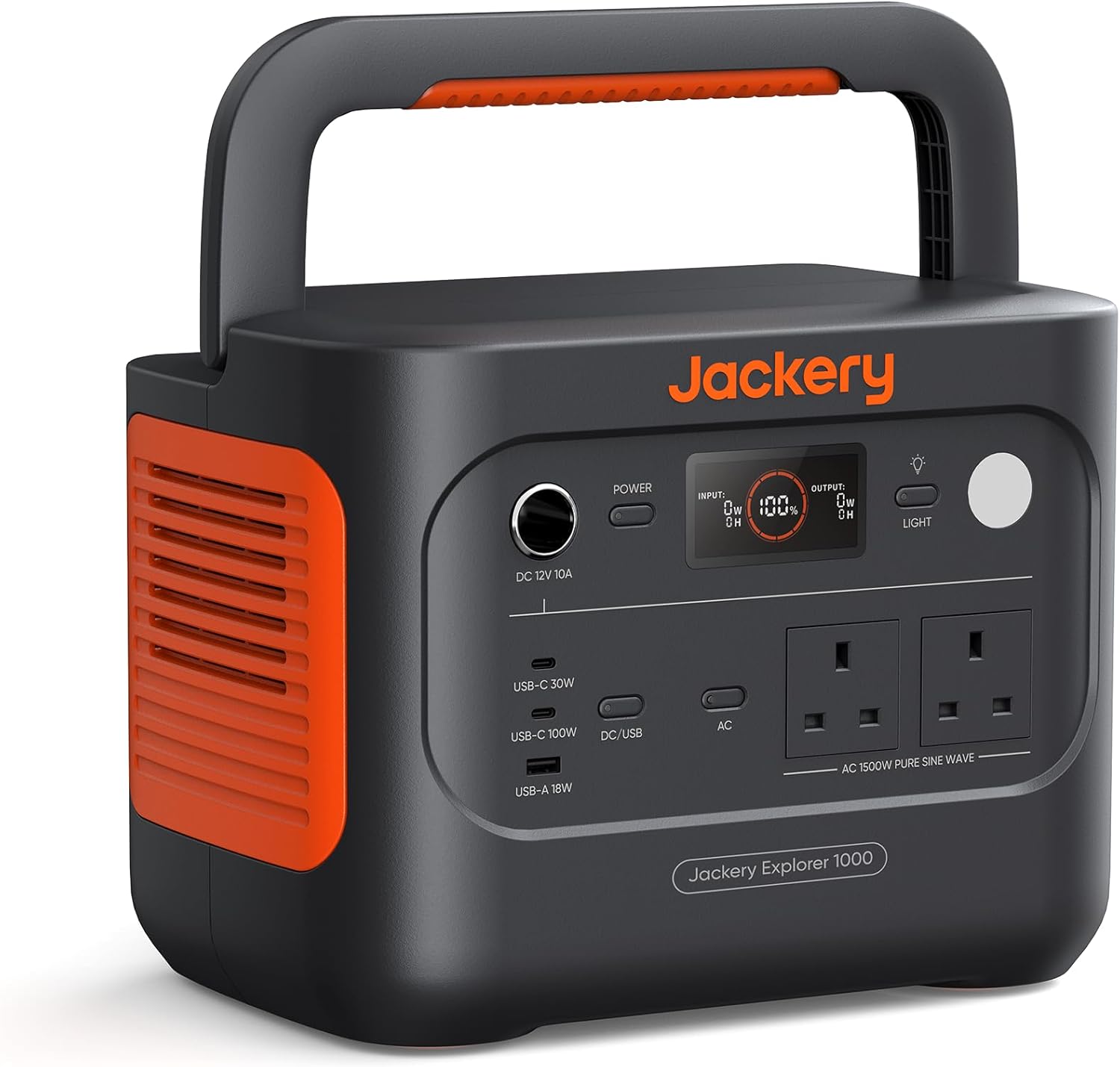

Based on the info you’ve given, I would suggest a Jackery Explorer 1000.
It’s got the capacity to keep you running for 6 hours while coping with the initial surge on job startup. It’s currently on reduction at £450 on Amazon UK, usual price £899.
It depends on if you think that is the price worth paying for offline power supply.
