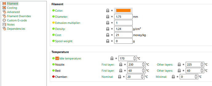

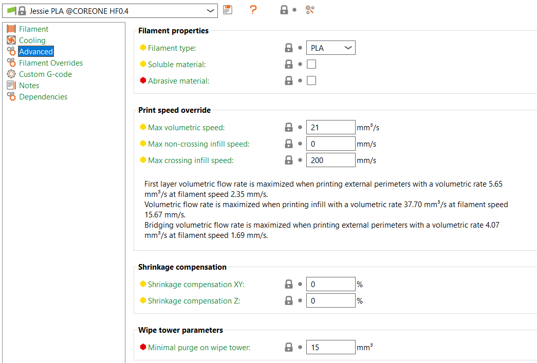

I reached out to Printed Solid to ask if they had any additional info on the Jessie PLA settings. They sent some screenshots for the preset in Prusa Slicer. Here they are. Unfortunately I don’t know what to do with this information.
This is the data you enter in the filament profile. Create a new profile or copy one and enter it:
Either edit:
or create a new one (recommended)
In Bambu Studio, you have almost exactly the same filament data and settings, just sorted slightly differently.

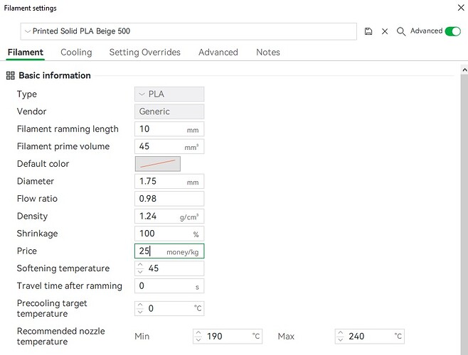

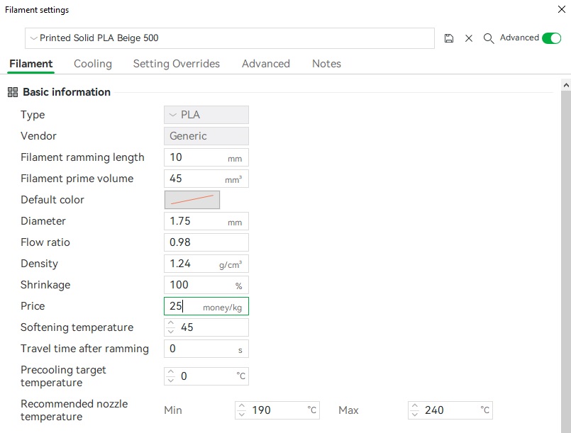

Thank you once again for your help. I made some changes based on the Prusa preset. Would you mind taking a look to see if I missed anything or made any errors? Do I need to do anything in the other tabs in Bambu Studio?

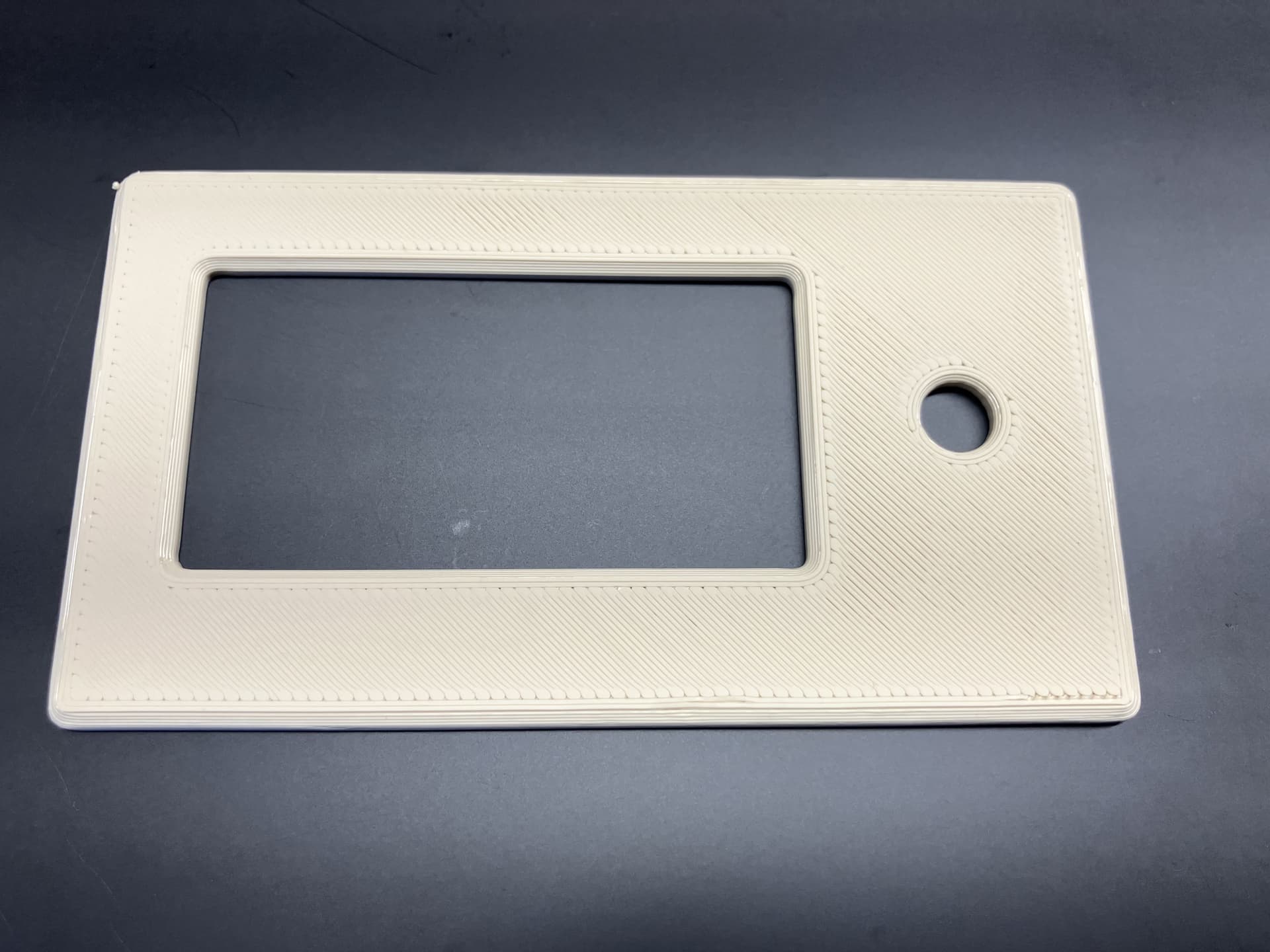

Here are a couple of photos of a recent print.
That looks really not good, but I’m surprised by the dark lines - I haven’t seen that before. Maybe they sent you a bad filament. To recover the situation, I would try the following:
Dry the filament
Perform now this calibration:
I’ll give that a try. All of my prints with other filaments are fine. I’ve tried two different spools of the Jessie.
The dark lines are gaps. I’m far from an expert, but it looks like the extrusion is inconsistent. Some areas of the print have gaps and others don’t.
I also installed Orca Slicer and am considering performing the additional calibrations that aren’t in Bambu Studio. Either way, I’ve wasted a lot of filament trying to figure this out. My experience with Printed Solid products has been disappointing.
That’s more than just “gaps.” Look at how dark they are, as if there were dirt or something burned. Or the material of the nozzle has worn away, I have no idea. Perhaps that’s just the photo misleading me.

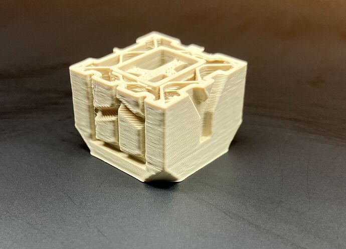

Trust me. It’s gaps. I even changed both the nozzle and sock. I just completed the flow calibrations. No improvement. Unfortunately I don’t have a way to to dry out the filament. I’ve tried the generic PLA, Bambu PLA as well as creating custom filaments. Here’s are photos of a partial Bambu cube that printed. I stopped the print for obvious reasons. I’ve read about people using this filament with the Bambu PLA profile and they claim that they got good results. My printer is fine. I get good prints using Bambu, eSUN and Sunlu fillamtents. There must be something about this filament that is very different from the others.
Well, from this photo, it looks like one thing to me: extremely moist. It has definitely absorbed moisture, but perhaps others will share their opinions on this.
Which would confirm this theory that you got a moist filament.
