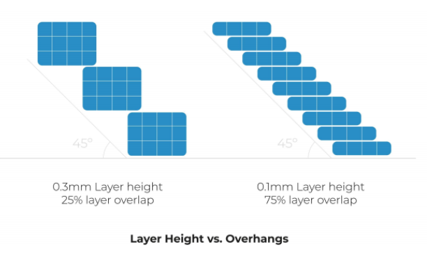

Based on your description, it sounds like the outer wall is getting dragged instead of staying put. If so, there are a few ways to tackle this.
  1. Layer Height will affect how much material the outer wall will have to hold on to. Contact comes from the inner wall and the layer below it. In the below example, the one on the left has very little to stick to. The one on the right has smaller layer heights which overlap and provide more contact for the outer wall.
    Since setting a small layer height for the entire model can lead to increased print times, you can use something called adaptive layer height aka variable layer height.
    Variable Layer Height | Bambu Lab Wiki
  2. Outer wall speed - lowering this value will give the outer wall a longer time to cool and adhere to the inner wall and the layer below it. To reduce it, there are a few ways. The easiest is to simply reduce the outer wall speed for the entire model. A more targeted approach would be to use a modifier to target just the overhanging layers for a slower outer wall speed. Another way to target overhangs only (without modifiers or slowing down the whole model) would be to lower the % values of overhang speeds (on the Speed tab in Process settings in Studio). Note that depending on the filament this can affect the sheen of the outside of the part. Generally I favour reducing the overall outer wall speed so as to get a consistent finish. But if speed is favoured over sheen, then the target approach is better.
As for which to use, sometimes you need both, sometimes one or the other. Both will affect print times. I would play around in the slicer to see how it impacts print time and whether it matters for your particular needs.
