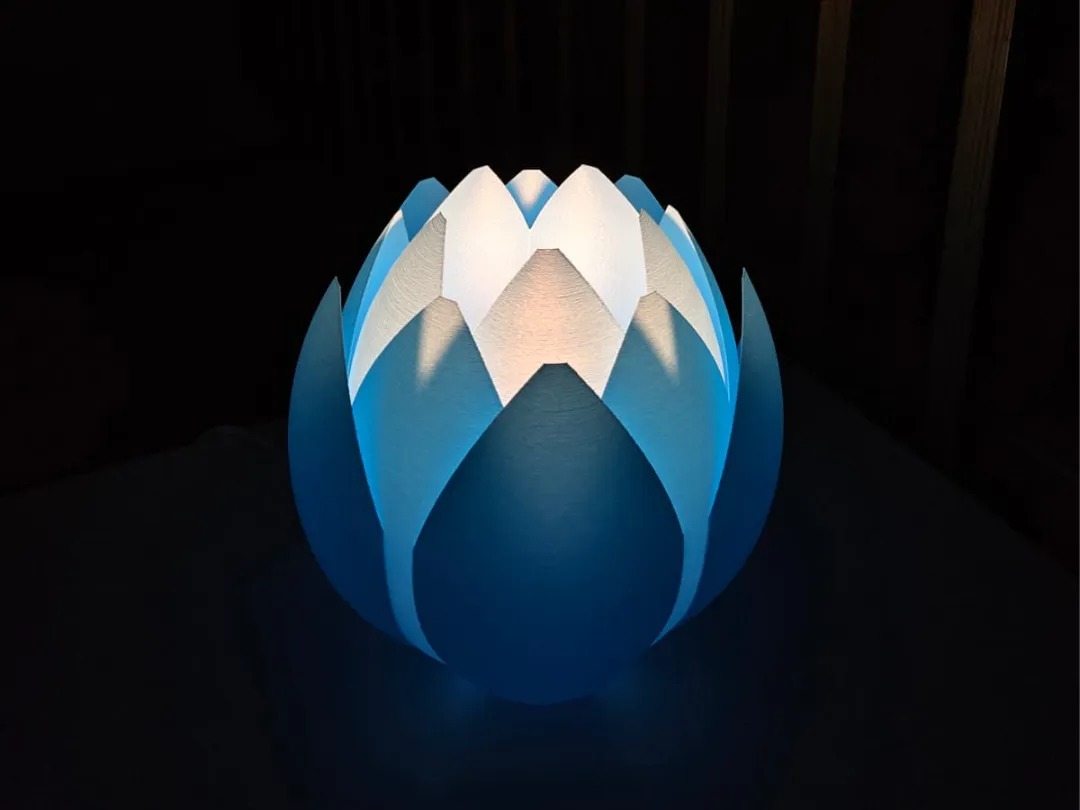

I’ve tried printing this model 5 times now. Every time is fails on the inner petals when I get about 40% of the way through.
I’ve tried changing the nozzle temperature, slowing down the speed, re-calibrating the printer, turning the fans down - nothing has made a difference.
failed-print
Are you using your own settings or the one included by the author of the 3mf?
Their settings are pretty opinionated on having a 0.7mm layer width w/ arachne, to fit the width of their cad model’s walls. Probably important to success
I never changed those settings, but I will double check.
This is what it was. I never changed those settings on my own, but for some reason they didn’t import with the model.
