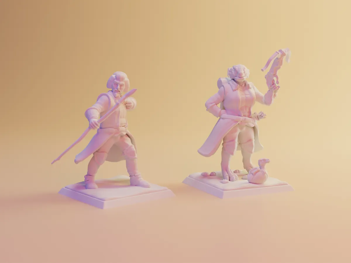

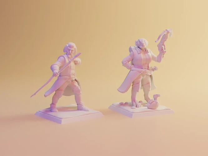

If you are talking of something like this, you definitely need a smaller nozzle. Almost all miniatures need one.
