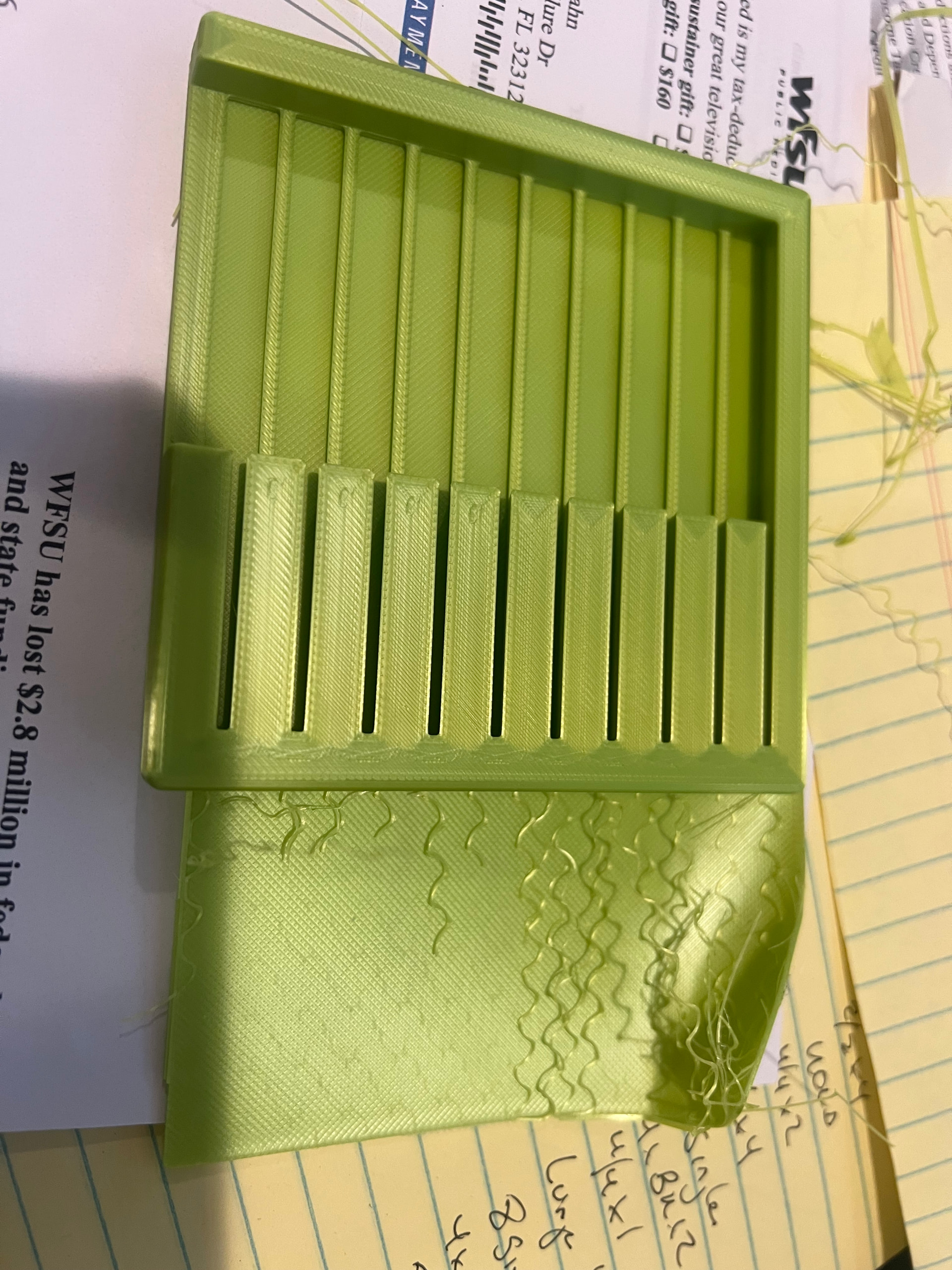

Trying to print a card holder and twice I have had this issue of the lower layer not sticking to the rest of the model. It’s Prusa filament PLA. I have a X-1 Carbon. Any suggestions on changing settings to make it stick better? I don’t need it to be quick if slowing down would help it stick. Thanks!

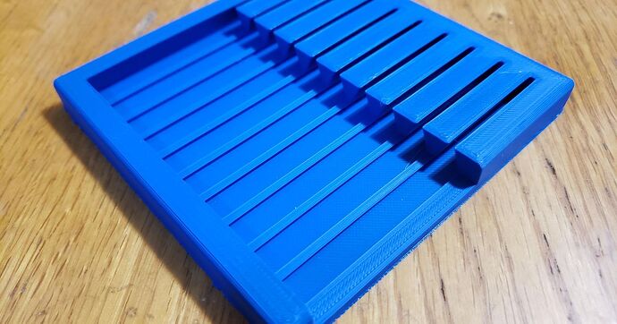

The photo of your print and the 3D model don’t look very alike. I can’t tell which part you’re holding there. The first layer is really just a big huge square. Your photo doesn’t look like a square at all.
Does it look like this in your Bambu slicer?
That’s what it looks like on my slicer. The slowe le speed didn’t solve it. It must be the filament because I have no issue with it with other filaments. Here are a few more pics:
Dry it out and maybe raise the temp of the nozzle.
You should calibrate your filament*. You could also look it up on 3dfilamentprofiles.com to see if there’s anything useful noted on there.
*Much of that guide will work in Bambu Studio, but the guide there is nicely laid out and in a good order.
Very important information. In that case, adjusting the settings probably won’t probably help either.
If you cut a piece of filament off your spool and bend it, does it break? Does it seem brittle? PLA straight from the spool should not break and should be easy to bend - even bending to an extreme degree.
If PLA is left lying around opend in a room for too long - say, for months - it can become brittle. You can definitely give it a try without much hassle and let us know if that’s the case.
I’m guessing - and this is just a guess - that your filament has gone beyond being “moist” and is now just brittle. I could be wrong, though - just test it to see if it breaks right off the spool.
