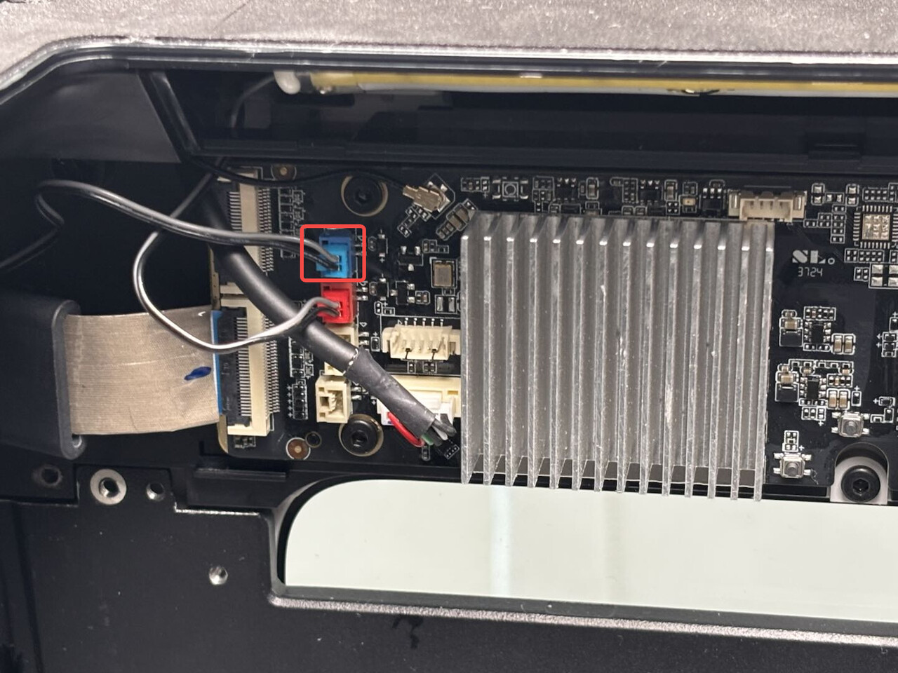

There is a light underneath the actual tool head and I wish you could turn off the two big lights and only keep on the nozzle head so then it has still a tiny bit of AI detection, but we less light levels, especially when you’re sleeping and the printer is nearby. Note the printer is multiple rooms away and when I keep the big lights on, it’s like there’s a sun in the other room

You could simply unplug the lights from the AP board? If you wanted to get really fancy add in a switch on the wire going to the light(s)? The connectors are the blue and red in the below picture from the wiki.
