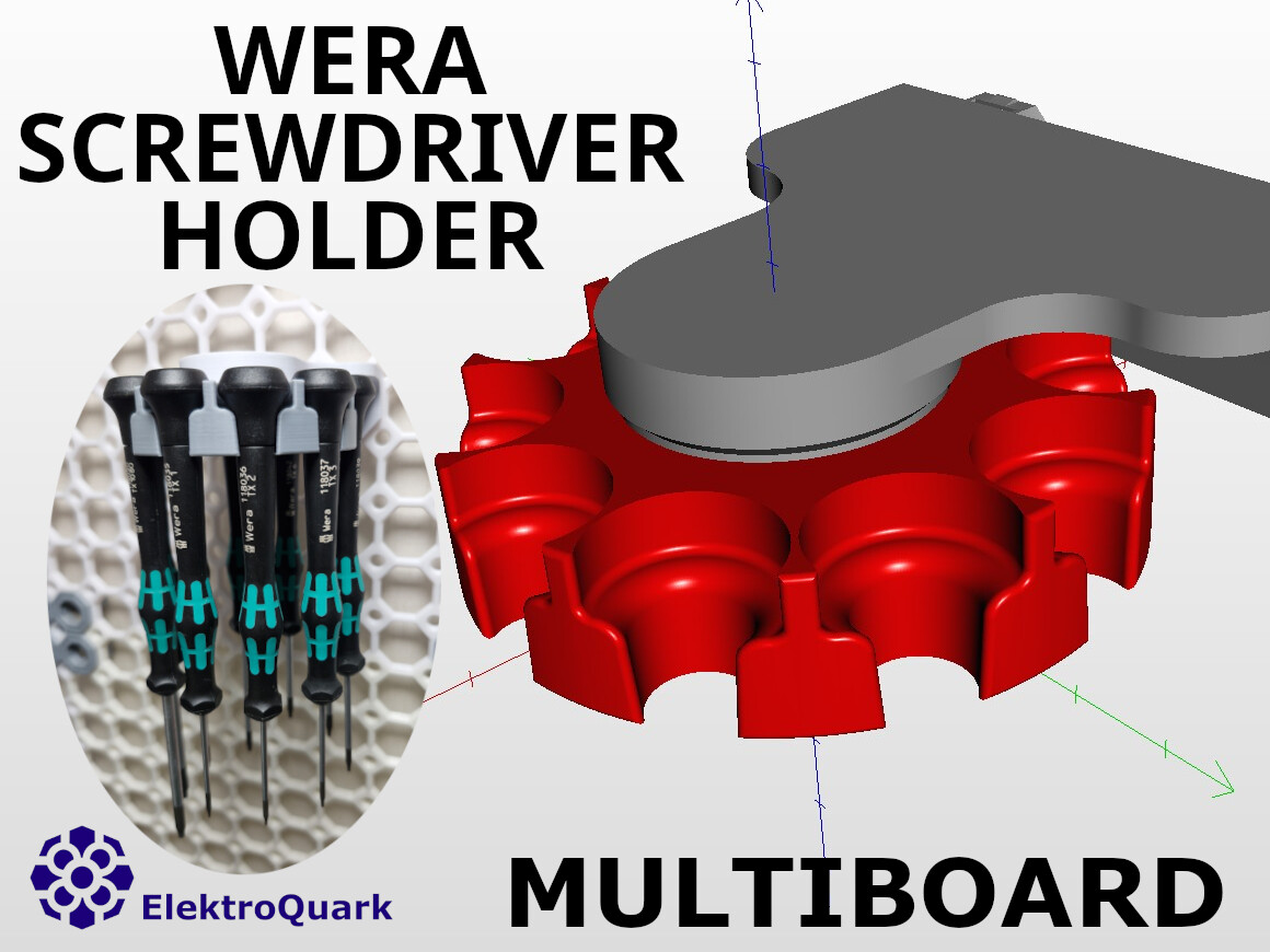

I have a Multiboard compatible rotating holder for them:

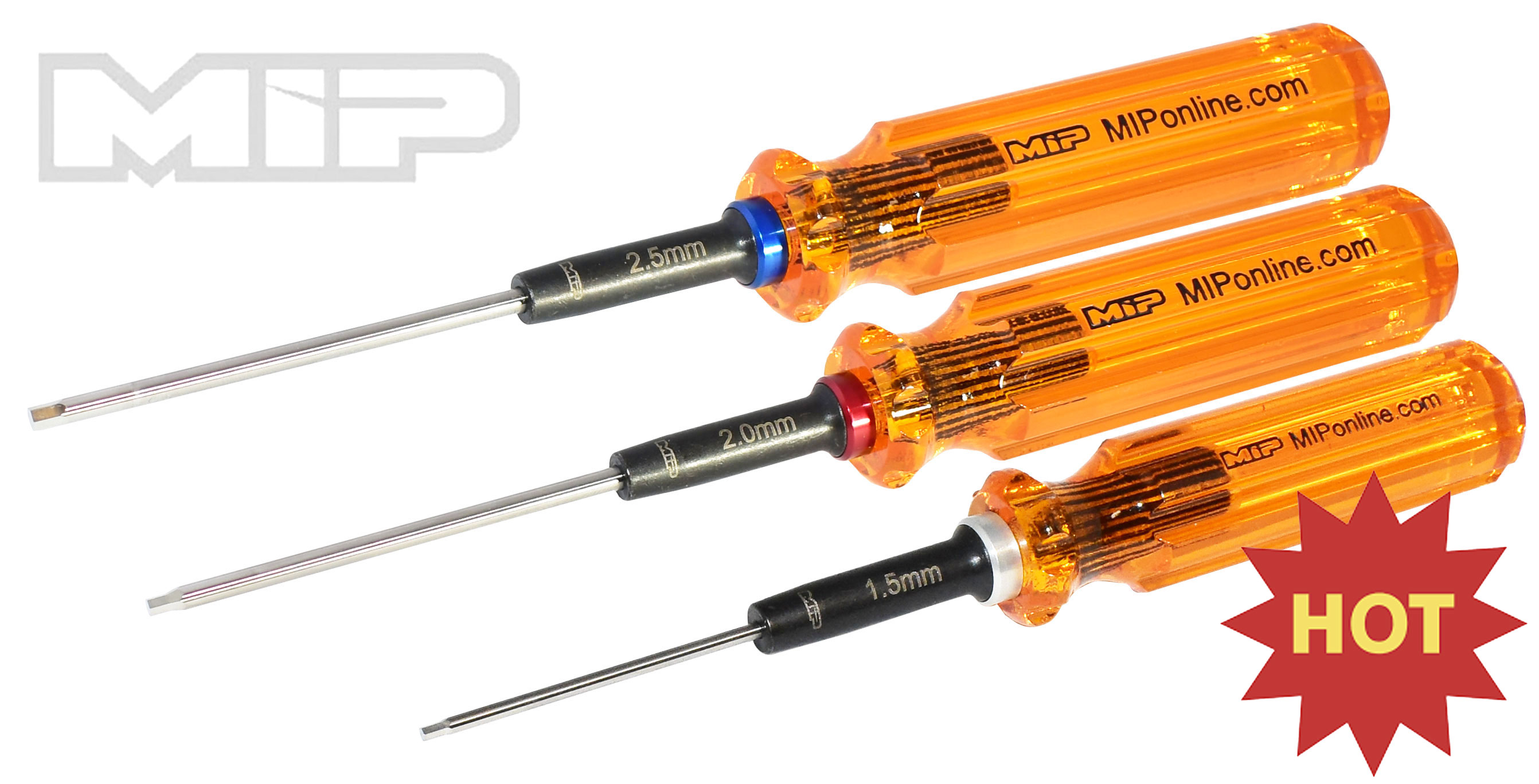

They’ve been rock solid. Better than the Wiha Precision set I also own. To be expected given the three MIP wrenches cost as much as a full set of any other wrench. The tips are ground from hardened steel rod, where I think many others are formed by stamping or broaching. They tend to fit the screw head sockets tighter, and because the corners of the hex tip are sharp angles (no rounding on the corners like you get from stamping) they don’t wring out the sockets as easily.
I have some other drivers that have ground tips like the MIP, weren’t as expensive, and many have broken. They have a much longer length of grinding, the hex is 10+ mm long where the MIP driver tips are only a few mm, just enough to get all the way in to a cap screw socket.
If you’ve got the money to spare, buy the MIP and you should never need to buy another driver again for the rest of your life. :slight_smile:

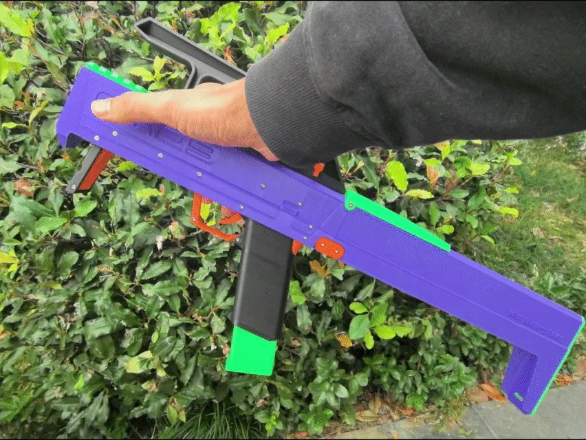

Unfortunately some of the hex screws sold by bambu are horrible quality, I found out when I was assembling the FMG9 water pistol. The M2.5 hex were fine but the M2 were from very soft metal and would strip under any kind of torque. I have top quality drivers (wera, MIP), so it had nothing to do with that. If the M1.5 are similar quality to the M2, I would suggest you pick up some better quality screws from amazon or aliexpress.

Yes some of the screw from Bambu are terrible quality, especially the M2. I posted about this on FMG9 water pistol comments, first comment there. I have top quality Wiha and MIP drivers and they are such soft metal that driving them into plastic stripped them, I now only buy from reputable sellers from aliexpress. Also when they are super small like M2 I prefer phillips screws they are much harder to strip.
