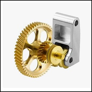

Does anyone know why bambu hasn’t offered a metal gear for the large extruder gear? I know it has the two smaller gears but was wondering why a metal gear isn’t offered for the large main gear.

There are several legitimate reasons Bambu may have chosen plastic for the large extruder gear.
Cost is certainly one, but plastic also provides lower rotational inertia, quieter operation, low friction, and a degree of mechanical compliance. It may also serve as a sacrificial component during a severe filament jam, protecting the motor, bearings, and smaller hardened-steel drive gears. The actual gears that grip and advance the filament are already metal, so the large plastic gear is primarily transmitting torque rather than contacting the filament.

The tooth pressure and rotation speed are such that there will not be any appreciable wear on the driven in any reasonable amount of time.
In some odd misalignment or extreme wear scenario, you want the cheaper part to be sacrificed, not the pressed-on gear that is part of the extruder motor.
On the other hand, if it were hard metal on hard metal, wear would be higher to both the extruder drive gear and the driven gear, and the driving gear would fail first, and much earlier than if it were driving a plastic gear.
It doesn’t need to be a steel gear. Even if made of aluminum, would still be better than plastic. I’m just looking at durability. If I’m not mistaken, well if googles not mistaken lol, it’s the smaller gears that actually drive the filament into the extruder but alot of clogs wind up with a small piece of filament in the large plastic gear. I just think all metal gears would be better to handle the constant moving of filaments for hours if not days. Plastic will give out long before metal will.

I can’t answer that but there is a remedy which I apply to my extruders.
While generally not a fan of BIQU electrical products, they make a part, the BIQU Panda Claw which is two parts. The extruder (big) gear and the spring loaded tensioner for the assembly. In the event I need to buy an extruder, I also buy the Panda Claw, remove the plastic gear and put the metal one in its place. There may be a friction issue as the reason BL uses the plastic gear but that depends on what that plastic gear is made of. PTFE would be too soft but but maybe that is why they do that.

Technically the extruder wheels are steel, just the drive gear is plastic
