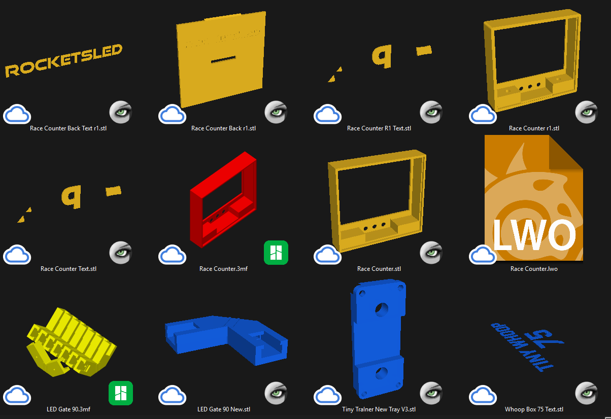

What’s more, if you install Windows PowerToys, you get an icon previewer for STLs. So when you have an Icon view turned on in File Manager, you see the STL preview instead of a generic icon.
