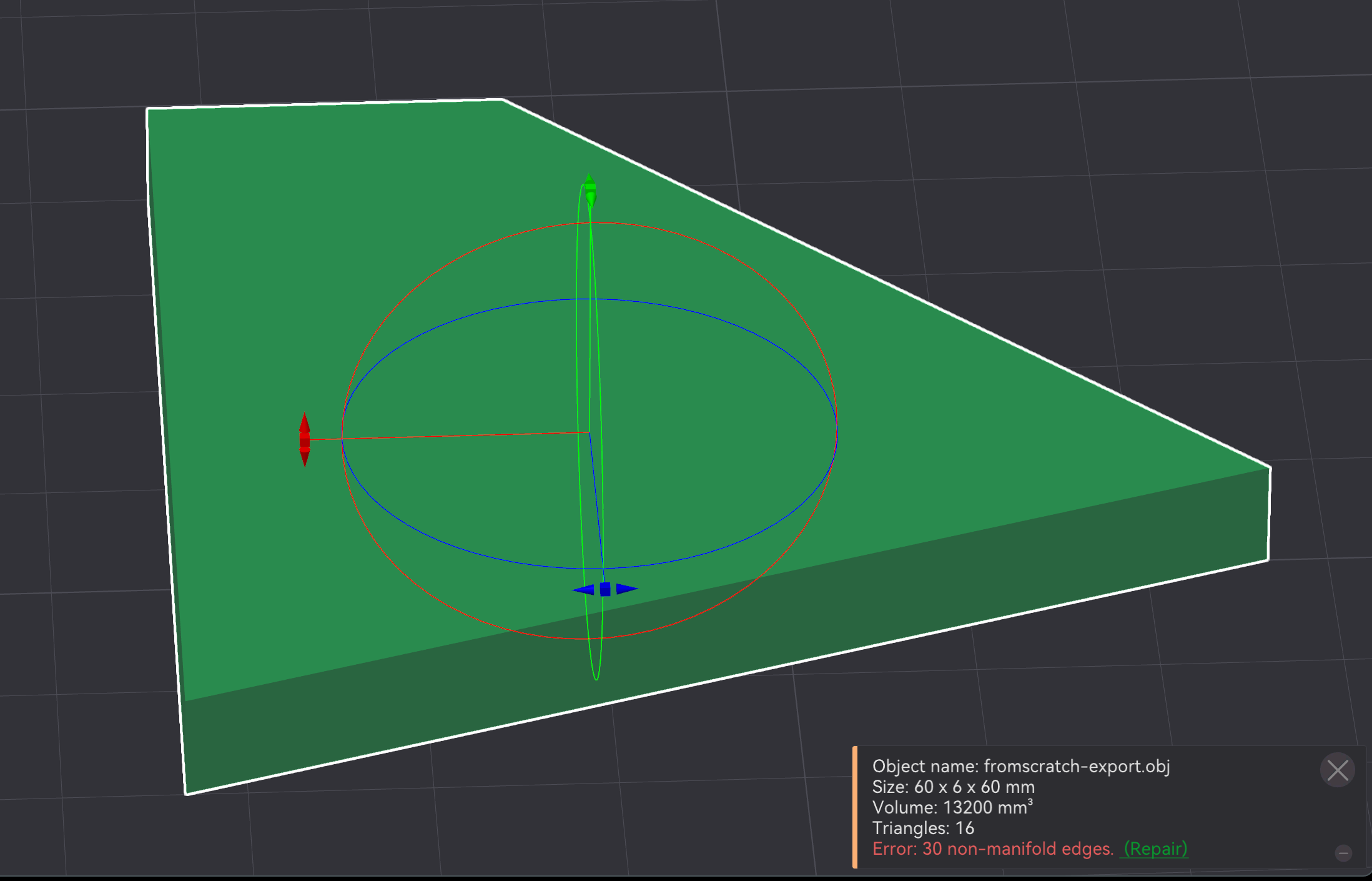

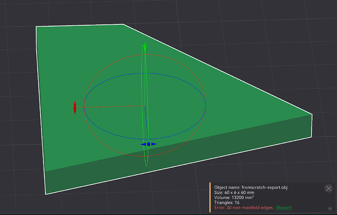

I know you’re still just getting started, but what immediately struck me is this: Even with simple objects, they aren’t manifold when exported. That’s one of the biggest problems if you want to 3D print them later. You should add a manifold check, especially for beginners who aren’t familiar with the term and wonder why it doesn’t work.

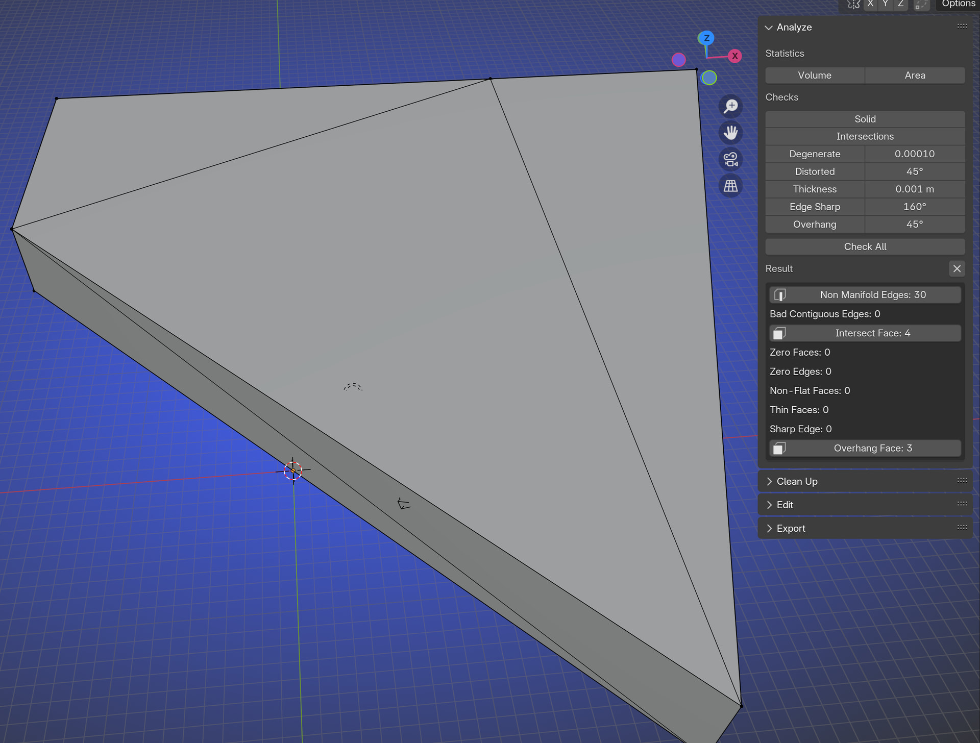

Blender confirms the same error: 30 edges are not manifold:
That sort of thing doesn’t happen in CAD software like Fusion 360 and all the similar programs. Like I said, I know it’s still in alpha, but it immediately caught my eye that the export is causing non mainfold problems. You should definitely take a look at that; otherwise, the software is not suitable for beginners.
Thank you very much for the feedback!
This is something I will work on right away.
Thanks for catching this — you were right, and it’s fixed now.
Good news: your model was never actually broken. The bug was in the export step, not your design. When two surfaces met at an edge, FromSketch was drawing that edge slightly differently on each side, leaving a microscopic gap — way too small to see, but enough for Blender and slicers to flag it as “not sealed.”
I’ve fixed the mismatch so edges always line up, plus added a cleanup pass that patches any tiny gaps that slip through. Everything exports fully sealed now, and you don’t need to redo anything — just re-export your existing models and they’ll come out fixed.
I also added the manifold check you asked for. If an export ever has a problem, it’ll now say plainly “open edges — slicers may refuse this” instead of throwing jargon at you.

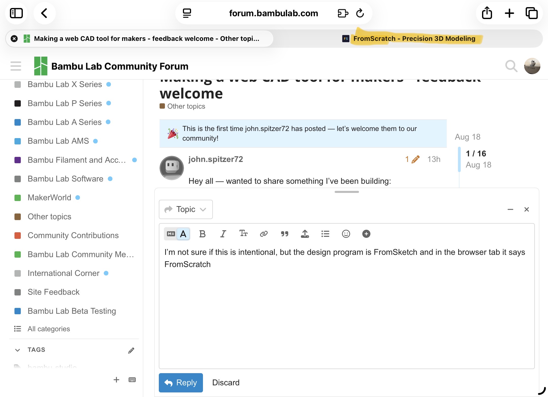

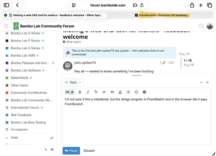

I’m not sure if this is intentional, but the design program is FromSketch and in the browser tab it says FromScratch
Good catch! FromScratch is what I first called this project when I started it! I changed it to FromSketch since I started focusing on the ‘sketching’ aspect. I was trying to lower the boundaries for users graduating from applications like TinkerCad - a simple way to sketch without worrying about constraints and then manipulate them.
