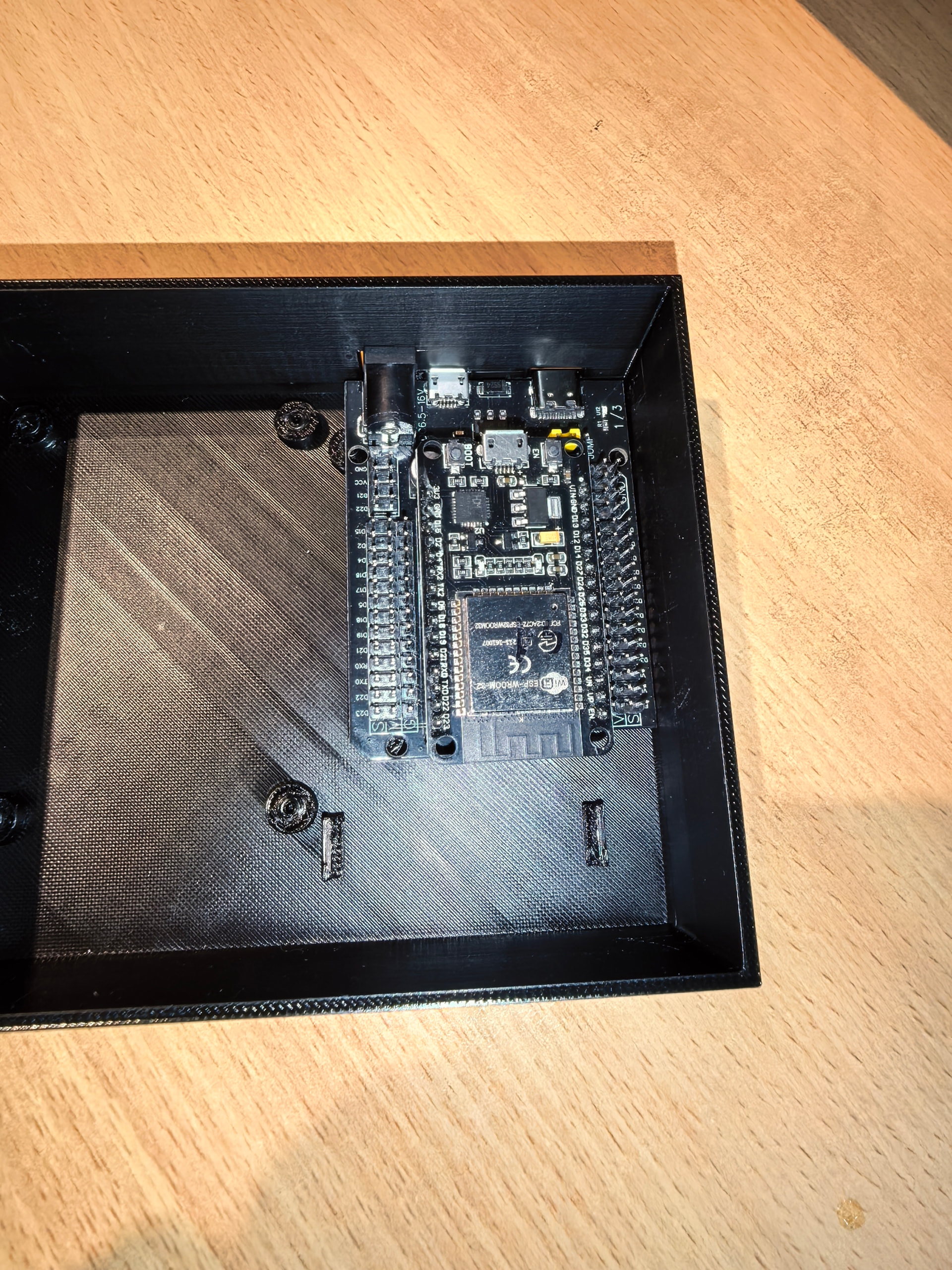

Making new design always failed
How do you create new desing with 3D software. Whenever I create something like a housing for some PCB or something else I never manage to make it 100% right. After I print first failed model I repair my design in 3D software and than test if all fits if not repair design again. So sometimes I print and repair design 2 times sometimes 3 times.
HOW do you create design so all fits first time when you create design and print it.
I just design a box for Arduino and again nothing fits in that box
When I design a box for a specific PCB I don’t print the whole box out first. I just print out the bit where the PCB fits. Then I can just tweak the results. It’s usually just small changes, like 0.5mm, that need doing.

thank you for advice. I dont model every day but when I need something and still learnig I mostly use fusion360 which is not that easy to use. And here are pucture of what I am talking aobut.
When I’m designing something that needs to fit an existing part, like a PCB, I’ll often make a rough model of it (the PCB) first. Then design my enclosure or whatever around that model. The trick is to model the ā€œPCBā€ with accurate dimensions where it matters (taking into account any mounted components, for example). It doesn’t have to look or be perfect, as long as the key dimensions are accurate. A flat PCB is easy to draw of course, though components can be more tricky. Luckily almost all electronic components have 3D models available for them (eg. from the DigiKey product pages). In some cases of course a whole device may have drawings/models already available as well.

If I was designing the box in your pic, I would do as @MaxThreeD suggested. Draw up the PCB. Do a 0.6mm thick print of the PCB and holes so you can see if everything lines up. Once the holes and size line up with the PCB them measure the connector and other things you need access to.
Once the PCB is done then its easier to design the box. For testing purposes you can just print out the corner of the box where the PCB is and not the whole box. You don’t even have to print out the full height of the box.

It might help to make a model of the PCB as another component, partly for Fusion practice, and also to check the fit against your box design. You don’t need to show everything, but include overall height, width, length, mounting hole locations, and port dimensions. Then move it into place to check alignment, clearances, and interferences.

When I design an enclosure for anything, I start by creating/finding a model of the stuff that’s being enclosed, lay them out the way I want, then design the enclosure around them.

Also, things like Arduino boards will have full mechanical dimensions in their documentation. Board outside dimensions, hole locations & sizes, etc. Their drawings are extremely useful for quick reference.
And it does take a little time to get good with that kind of thing. You have to allow for printers to decrease clearances by giving things just a bit extra. Also, when working with circuit boards don’t forget clearances for through-hole fittings that stick out on the bottoms/backs of boards, connectors, etc.
