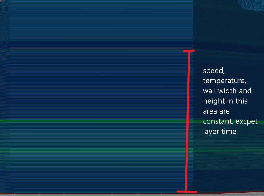

Matte PLA Nardo Gray: discoloration by layer time
I’ve printed a lot of BL matte PLA colors without this particular issue. Typically, layer time won’t affect color this much if speed, temperature, layer width and height are constant throughout the discolored area.
Ash Gray, white, dark chocolate and black of the same print doesn’t have this issue. It’s the first time I used Nardo Gray, I’m wondering if it’s this particular color or I got a bad batch. Could someone please confirm this? thanks

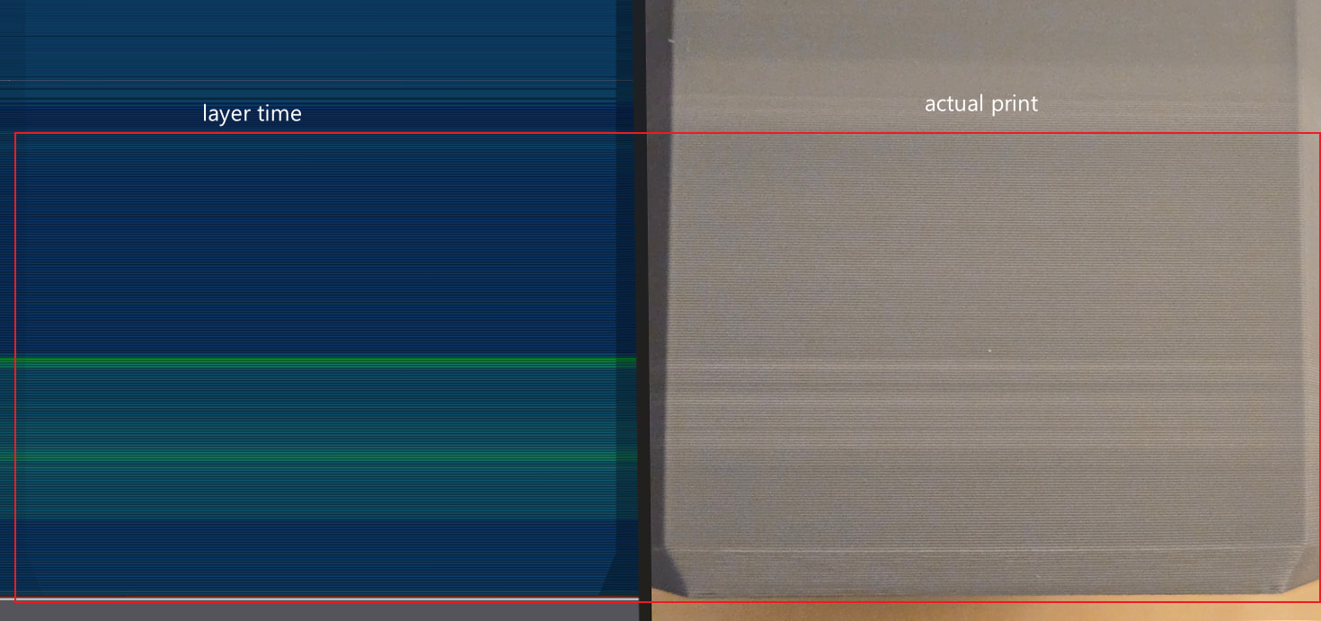

Can you mark up the real life photo to show which corresponds to the red region below?

There are internal geometry behind the bottom discolored flat area, which is why layer time is different there, but other BL matte PLA colors don’t have the same issue.

I don’t think it’s variation in translucency. It printed with 0.4mm nozzle, 2 walls and 5mm of infill before the internal geometry changes.

Drying improves the banding quite a bit, but does not eliminate the banding completely. It also makes it slight darker too.

It’s a hexagonal shape with hexagonal symmetry internally, so each side should prints the same. But it didn’t, the banding is most prominent on the side where layer starts and it gets less prominent with each following side. The banding is pretty much not noticeable on the 6th side where layer ends.
