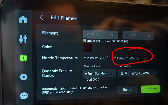

I increased the temp on a user preset filament profile (ie moved petg hf nozzle temp to 265c) and ensured the min & max settings were below and above that nozzle temp. Then I ran a flow dynamics calibration.
When I go into the filament section of my h2c screen and select the petg hf spool > edit, I can ensure that the proper flow dynamics pressure control is selected.
But right above that it has a min and maximum nozzle temp listed (max 260c) - is this limiting my user preset profile? How do I fix this?
In your second photo (the filament settings in the slicer) , Have you tried setting the Nozzle temp at 265?
Your second picture, we cannot see the setting, as it is cropped at the bottom.
Yep, for sure. I just decided to run it anyway and it held at 265c so that was good, the min and max on the filament screen must be overrode by the gcode in the file
