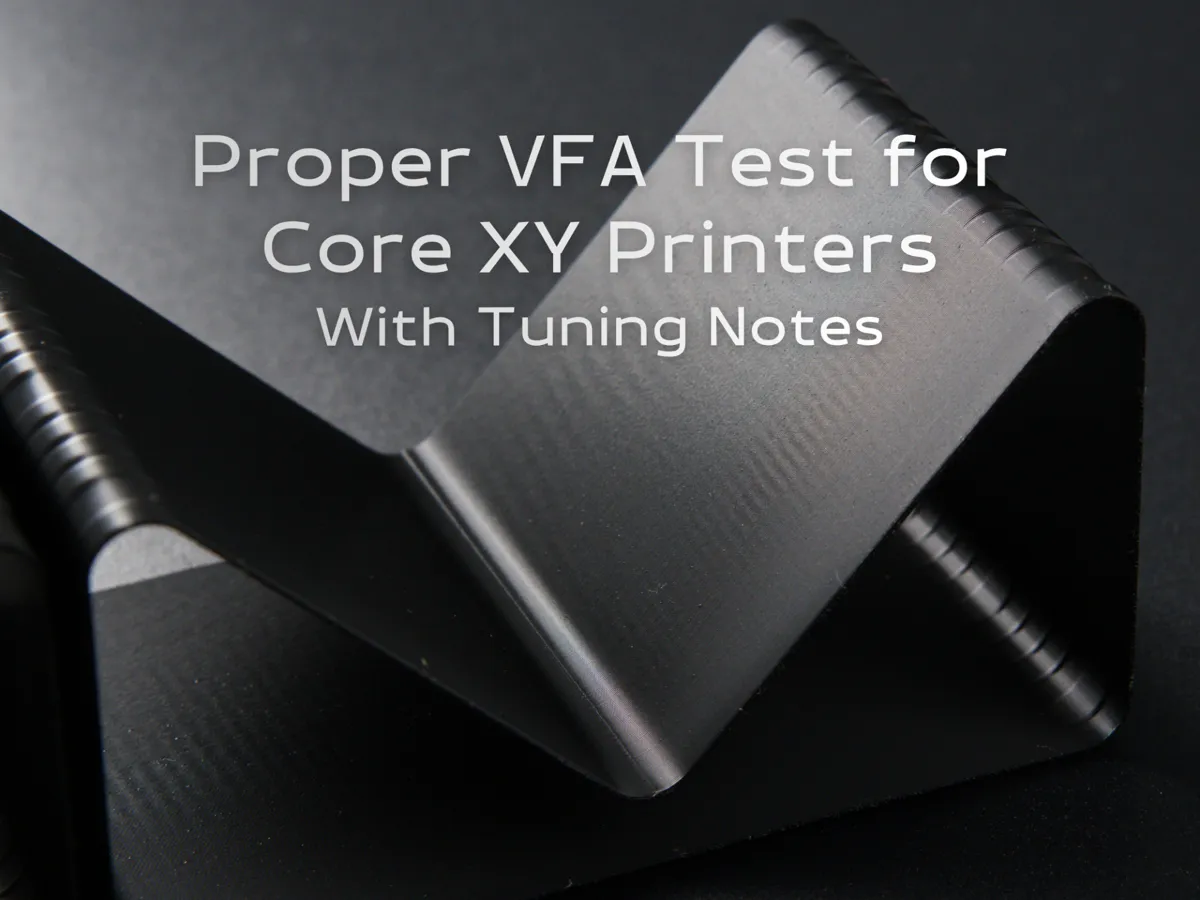

I want to control speed because the faster a print, the crappier they come out for me, when I slow them down the VFAs are usually a little better. I print a lot of silk and TPU.

This is a calibration issue more than a speed one.
If you calibrate the filament, you can choose the best looking outcome of the choices presented so any speed changes are automated.
This leaves you the fastest speed available combined with the quality you should receive.

Have you done everything on this page?

It lists calibrations, ignore the printer type.
The VFA calibration is listed.

Holy cow! I was thinking of downloading Orca because I was tired of trying to set up my own temp towers retractions test etcetera… developer mode!
man… that would have saved me so much time. I did the VFA test it is quite interesting. At 0 degrees I get almost none until I reach up around 100mms
between 30 and 60 its awful. I did my tower in silk. Looks like between 40 and 60 is my safest speed all the way around.
