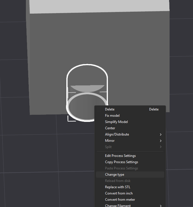

Trying to add a magnet hole by adding a cylnender then using mesh boolean to do a subtraction. This works but the colouring of the model goes back to a single colour
I have done this before but an update must be messing with things

You don’t need to do a boolean to remove the cylinder. Add the part as a “Negative Part” or select the current part and use “Change type”. This will remove the area but not change your current model.
Thanks will give that a go
Thanks Jon, that works a treat
