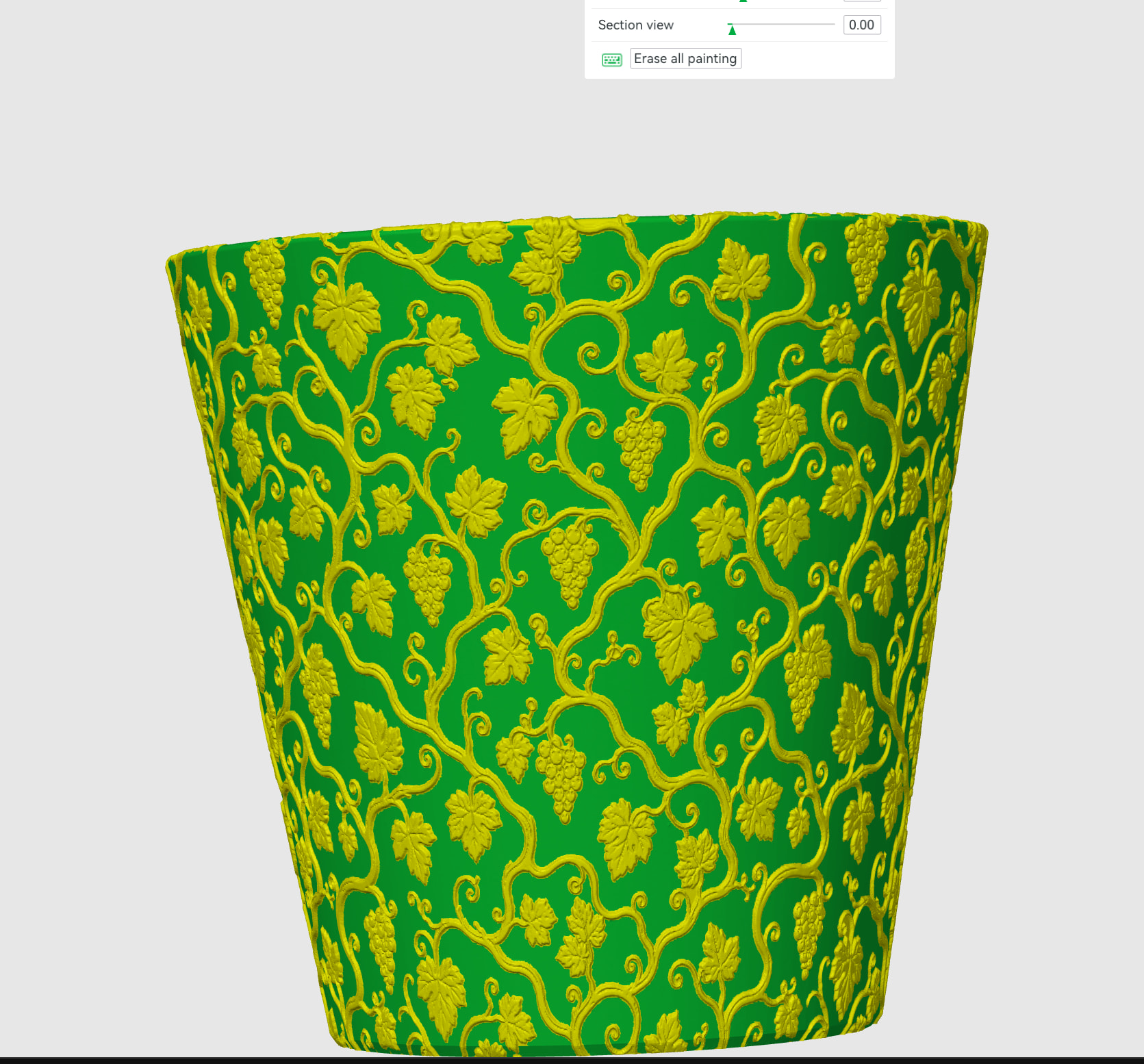

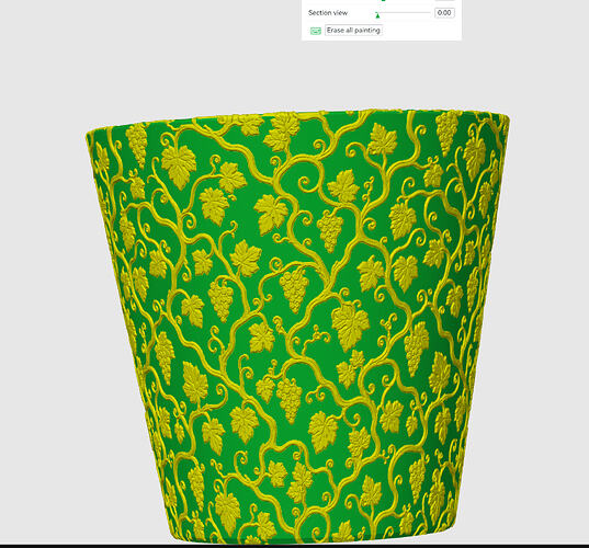

I used the tool at https://bumpmesh.com/ to generate a textured version of a basic pot. My goal is to paint the extruded sections to achieve a specific visual and structural result: eg this:

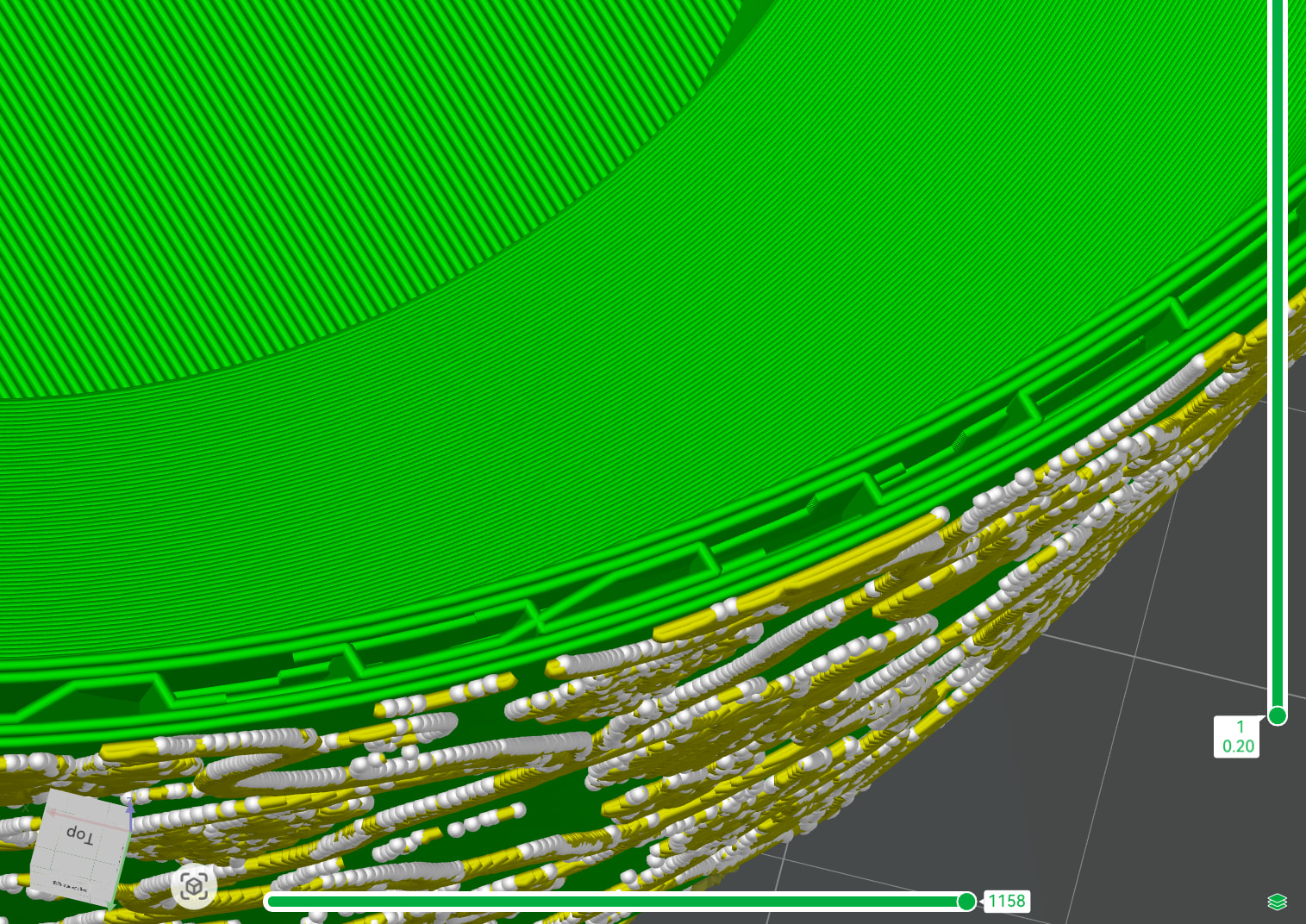

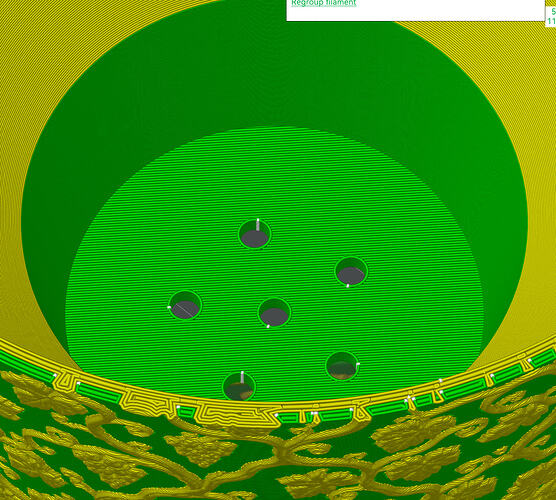

Initially, I used the Modifiers + Assembly workflow to align the modified (textured) pot with the original model. I then applied color changes using the original pot as a modifier. However, the resulting sliced model is structurally weak because the colored sections are not interlocked with the base material. Enabling beam interlocking does not sufficiently resolve this issue.
As an alternative, I used the Paint Fill tool. This approach produces a much stronger result, as the painted regions integrate better with the model. However, painting—even when using the edge fill tool—is quite tedious and time-consuming
