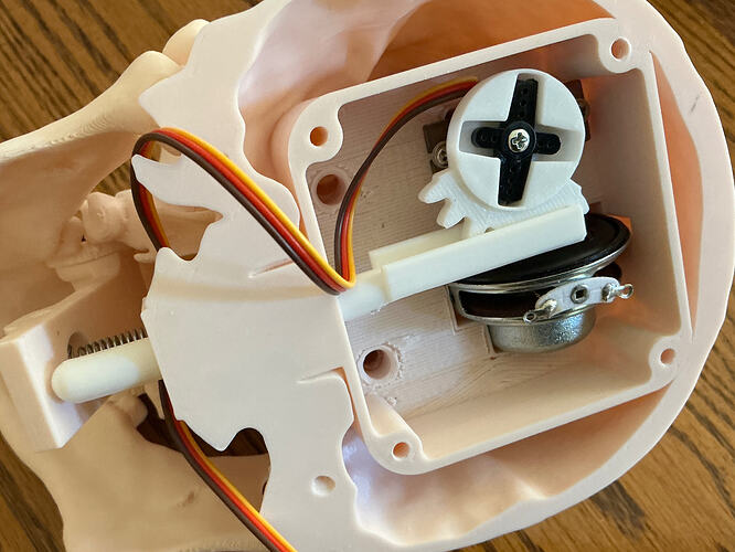

Why textures on a print object? Depends but here is wood grain applied to a backplate to make it look like a wooden board, and a hammertone texture applied to the “bronze” knocker parts.
The bone meshes were then added to the board and colored white in Studio. In the skull part, a hardware box and mounting bosses were added to the inside of the skull to hold/mount the knocker actuation servo and a sound effects speaker. The eye stalks also got meshed with the skull. So far this has been the most involved project I’ve done using Fusion with applying textures and joining meshes. It’s really a cool capability.
