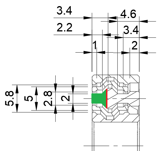

Hello there,
I’m pretty new to the 3D printing community and bought a A1 couple of weeks ago.
Yet I’m facing a problem that seems quite advanced to me and I can barely find informations about this specific behaviour.
The challange is to construct the most small and compact (cylindrical) rolling bearing possible to print with a A1.
I’ve got some inspiration from available bearings on thingverse and makerworld but want to add some of my own constructive ideas - as well as more oriented like real bearings.

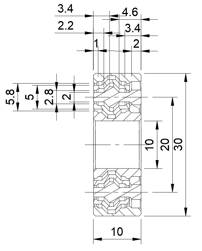

My current approach looks like this:
These most important dimensions should give you a impression about how minimalistic I’m thinking of.
Dimensions are mm.

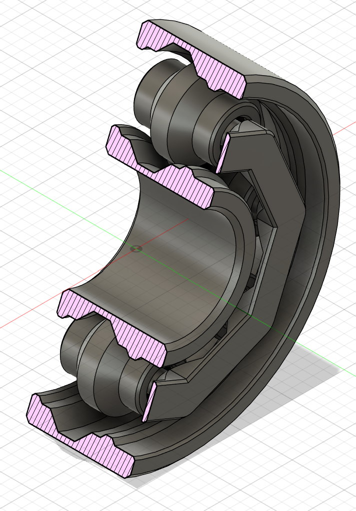

The sliced part looks something like this:
I’m facing a problem at the first layers of the 45° overhang at the inner cage-holder-axis part for the cylinder rollers.
The problem:
For a unknown reason there comes a quite strong force on the small inner bolt, that ripps it completely off the plate.
Sometimes earlier, sometimes later, sometimes it even breaks off neighbour parts as well.
Once it even kicked the (single, inner) part meters away from the printer.
Green part was printed fine, at the red marked layer this part somehow explodes.
Those flying bolts got a diameter of 2mm and are about 3mm long
Question is what force causes this, where it comes from and how it can be reduced?
Since the print itself looks quite fine, I still hope to get this done somehow without increasing its overall dimension.

The overhangs bend upward when they are not cooled fast enough. That’s why the nozzle hits them later on.
Since the parts are quite small and the printing head does multiple ‘rounds’ in a small area, a lot of heat is introduced into a small area which makes the problem worse compared to a larger part.
You need higher cooling fan settings, maybe also add or increase the aux fan if not already done.
Also check the cooling fan speeds in the preview view to see if and where it id running at what speed.
You can also try PETG, it needs less cooling in general and thus is less prone to this issue.
