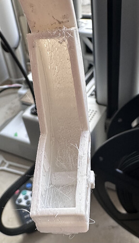

Hello, I am trying to Minimise strings for printing my 98A TPU filament.
I am making a hollow wristband - The results are not so stellar because it creates a lot of strings. I tried a few settings (avoid crossing walls), but nothing solves this issue. Is there a way that the printer always traces the outline and not crosses into mid air?
Any suggestions?

Is it properly dried ?
If not I would bet that’s the problem :wink:
Well, it was stringy right out of the box when I bought it. I’m quite sure that TPU always generates some strings. I was hoping for some slicer adjustments to mitigate this problem by avoiding unnecessary ways for strings.

I had the TPU in the oven for 8 hours now and it does print with better results!
But this procedure is a huge pain in the butt…
Is there another flexible material that is less prone to absorb moisture ?
Once it’s dry, work hard to keep it dry. Either build or buy a dry box (air tight box with desiccant) or use vacuum bags with a desiccant holder of some kind. Eventually you will need to dry it again but this way, it won’t be every time. You can print a desiccant holder that fits in the center of the spool or use a cotton or organza bag filled with desiccant and stuffed into the center. I use vacuum bags and desiccant and don’t dry between prints, going a month or two between prints. Having said that, if I want the best print I can get, I do print straight from the dryer. Maybe one in 10 prints?
