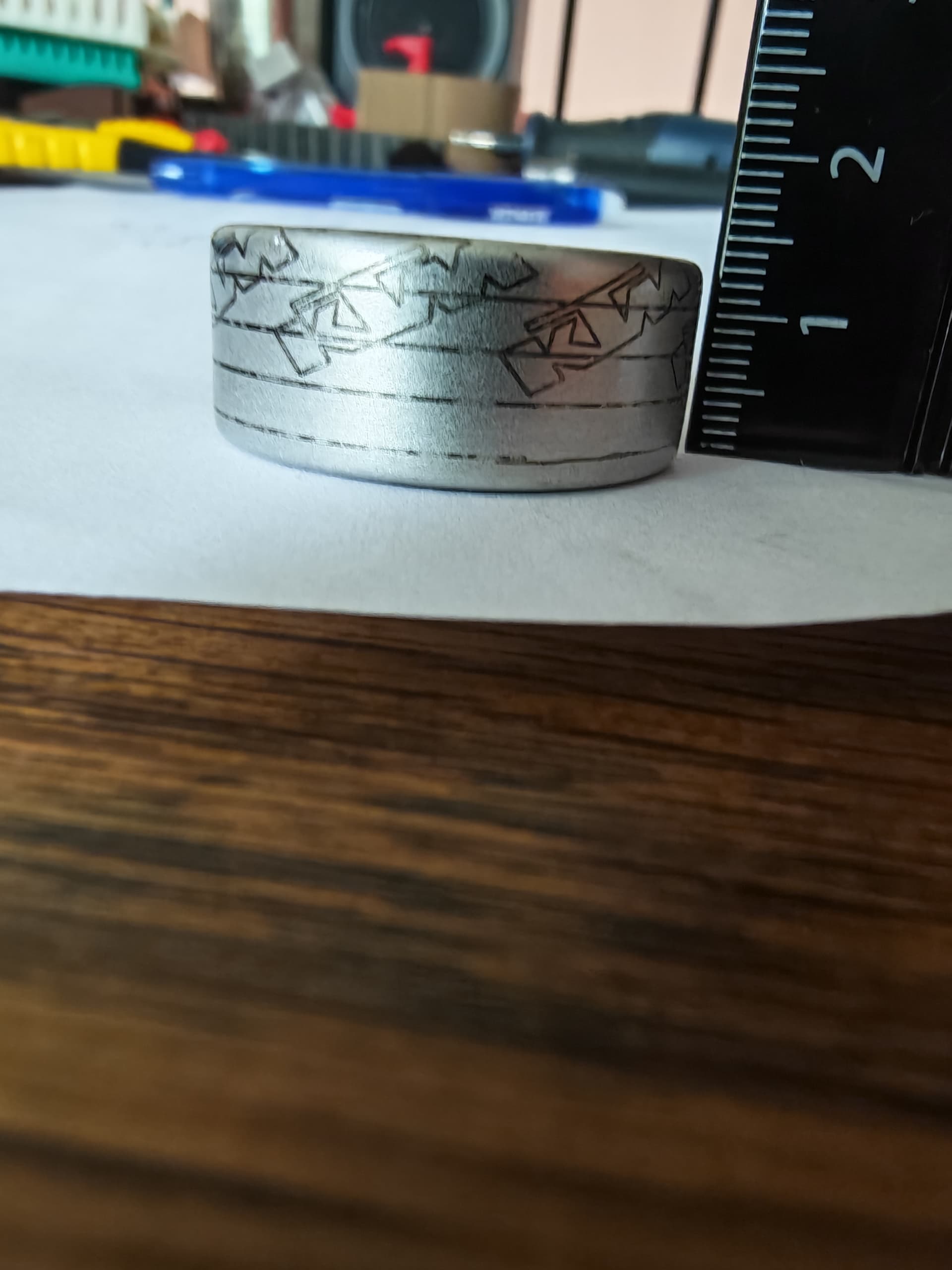

I suceed round engraving big objet :
But now i want to engrave a ring. it’s impossible to launch the prepare process saying ‘it didn’t detect the objet’ . i tryed with my own measurement .but it was totally offset ?
can somebody try? and let me know .
thanks

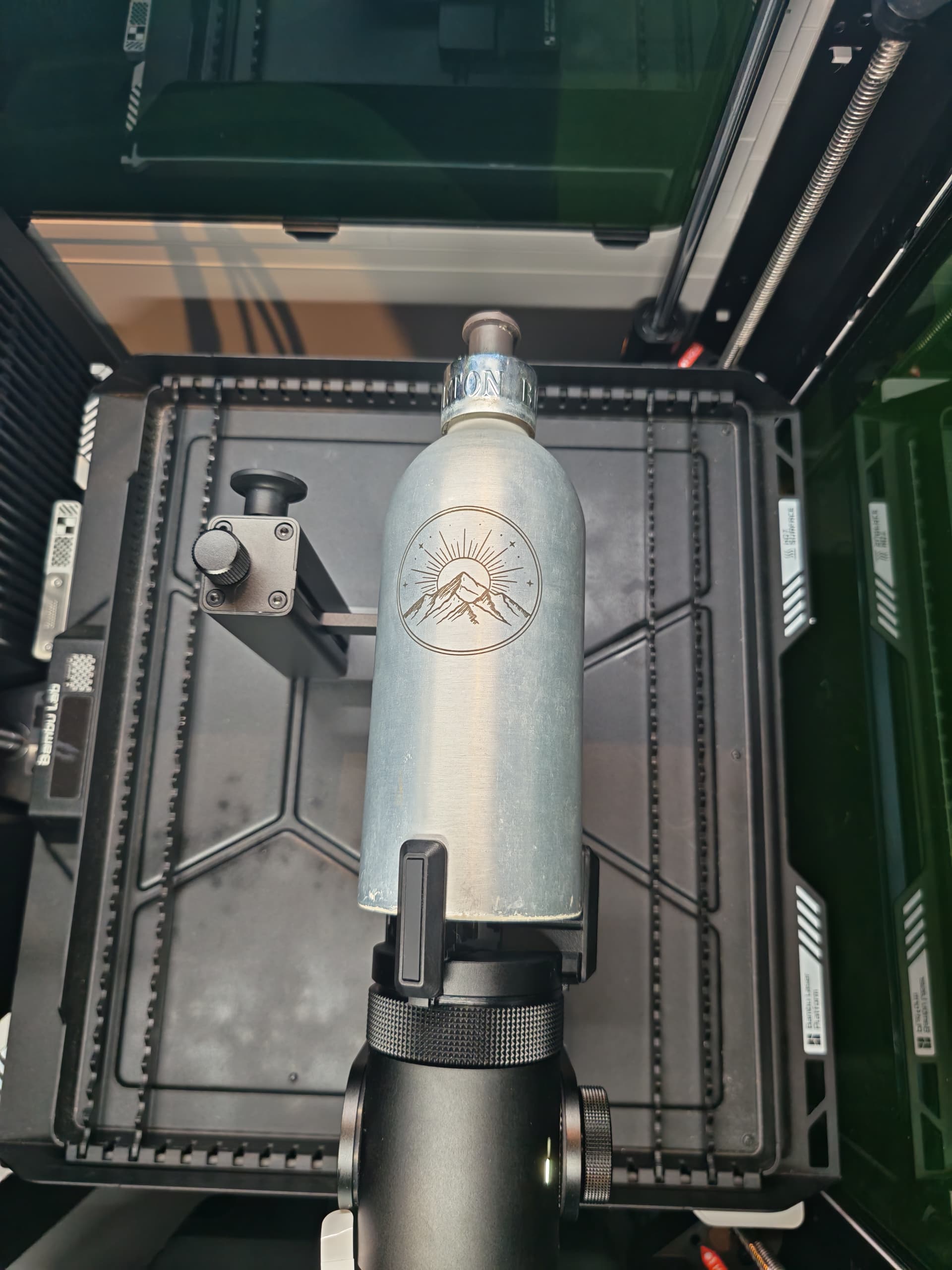

yesssssss it works…
i was so disappointed not to be able to engraved small peaces :sob:.

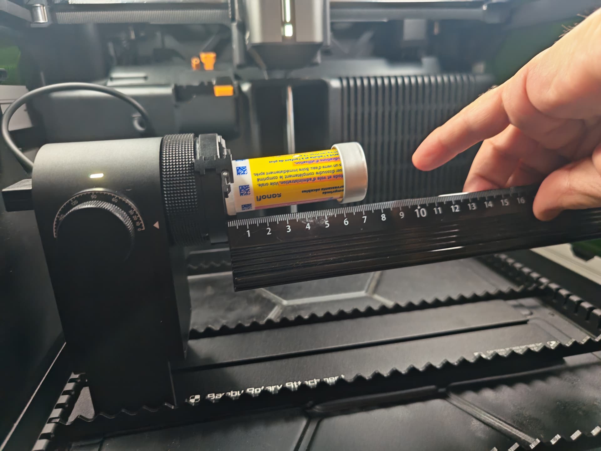

you can set up your own measurements and just launched the task.
just there are some offsets:
  • center axe is 106mm hight (just add the radius of your object).
  • and you have to remove 11mm from the lenght you really measured from you object.
A quick test :
