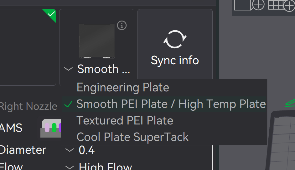

With my H2D I am able to select Smooth PEI plate/High Temp Plate. I use that setting along with a bunch of other settings to make the part I’m printing turn out correctly on my H2D, looks great.

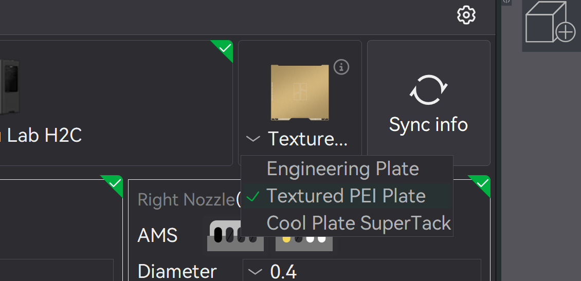

On the H2C, I select PEI plate, since I don’t have the smooth option, set all of the same settings but the print is slightly worse than on the H2D, the first layer isn’t as uniformed.
I’m thinking it has something to do with the build plate difference.
Other than temp, what do the different build plates change?
Why is Smooth PEI plate missing from the H2C?
Here is the H2D
H2C
Probably because Bambu doesn’t sell a smooth PEI plate for the H2C. IIRC that plate was phased out around the time of the release of the H2C.
When using a smooth plate on my H2C, I’ve been setting the slicer to Engineering Plate. Is this good/bad? I haven’t had problems yet.

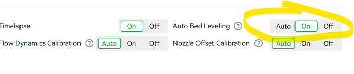

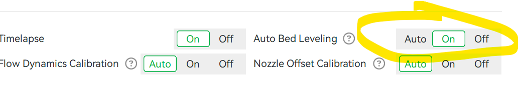

Force auto bed leveling to on, not auto. There is a bug that results in a wrong offset.

Yes thats completely fine. The plate type sets the temps and for most plates except SuperTack they are the same. The only other exception is the textured plate on which the Z offset/squish is slightly higher. I use Engineering setting for any smooth plate, and SuperTack for Frostbite. But even if you forget and set Textured PEI for any other plate type nothing bad will happen. In fact I often set Textured PEI for Frostbite/SuperTack plate for more heat and better adhesion for items with small contact patch so I dont have to use a brim.
