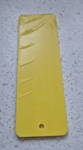

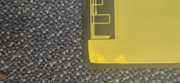

I printed 4 plates and placed them at the very front of the build plate closest to the door. But when it printed these they were the worst so far… the ones on the left closest to the cabinet fan were actually lifting up towards the end of the print - which makes me think they were cooling too quickly and shrinking - causing the prints to lift… pictures below…
This is so frustrating as I have an order for 16 of these and so far have thrown about 20 away!
The build plate is (as far as I can tell) spotless and I usually print these in 1’s and never have a problem - so am really hoping to find the reason.

I have dried the filament (again) a couple of days ago as I have a Sunlu S4 drier - and with fresh silica the AMS is showing 13% humidity - so I am sure this is not the case.
The plate is clean (been cleaned every time I use it)… I cant use brims as the issue doesnt appear to be adhesion and these are decorative items and the brim will spoil the front face which is printed on the bed. The issue is scarring on the top of the print (which is the back side of the item).
Office is usually at 20-25 degrees C and the cabinet is usually closed up.
I cant move parts further from the cabinet fan as I have the whole plate filled.
I dont want to drop the print speed if I can help it as the print time is already over 22 hours for the 9 items. Layer height is at 0.08mm HQ using a 0.2mm nozzle.

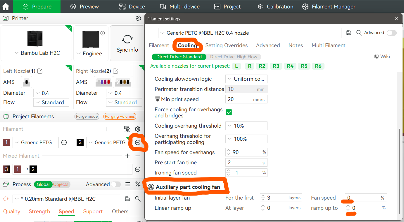

Am I right in assuming that the warping occurs only/in particular close to the aux-fan?
In that case, you could set the aux-fan to 0% in the filaments cooling settings.
I have found playing with cooling to open pandoras box though. So I prefer to just slow down. But for simple, flat shapes, it may be another option.
Addendum: Aux-fan settings:

Just as an FYI, this is the default setting for the filament being printed for the majority of the item…

Have you tried only printing a half plate with the parts all in the middle? The pics indicate warping to occur at the edges of the plate (which can be expected). It is not a satisfactory solution but it may help to reduce the pain.
I did print 4 in the middle and they worked - then tried 5 in the middle and the top surface was ruined.

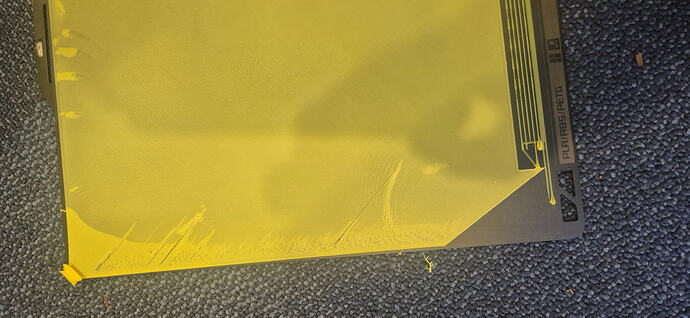

I have just fitted a brand new plate and am about to try 4 again. I did the whole plate test print which looked like this…
Mhm, some of those spots are a bit curious. Like that comma above the calibration arrow tip. A few edge effects can be expected though.
I assume that you are quite meticulous about plate cleaning and bed levelling so it looks like a bit of a temp drop towards the aux-fan?
A 5-10°C increase in 1st layer may help somewhat in that case, but it does not actually adress the root cause of warping.

I only observed that the 1st layer test seemed to be a bit worse on one side. A bed tilted beyond the ABL abilities would be a possible but very remote explanation. It’d fail much more spectacularly.
I just fear that the part dimensions and thermal interactions will force you to do these parts in half batch sizes or at slower speeds. Sometimes, physics just impose some limits.
