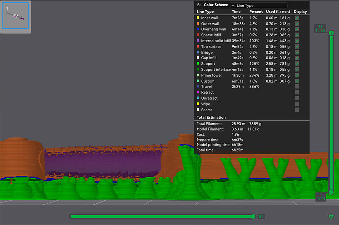

Any Info on why the handle of this sword seems to be missing in the software? It appears like it will not be printing the entire section except for the top and bottom. Missing the entire middle section. Any Help is appreciated
I was able to cut the part and add a connector with the Handle orientated in a different direction and change the slicing style mode from regular to close holes, and this resolved my issue.
