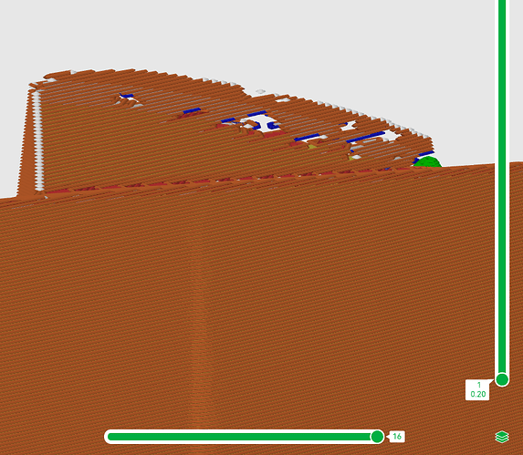

I’m trying to slice a model, but every time I try, it ends up missing parts of the layers. The wall thickness is bigger than the nozzle diameter. Also, it works just fine in Cura for some reason. Here are some photos…
I had a similar issue that was resolved by changing the wall generation type to “Arachne”.
This resolved the issue I was having like this.
I think my walls were too thin or narrow and it wasn’t generating them. Can you make sure your design in this area is not hollow?
