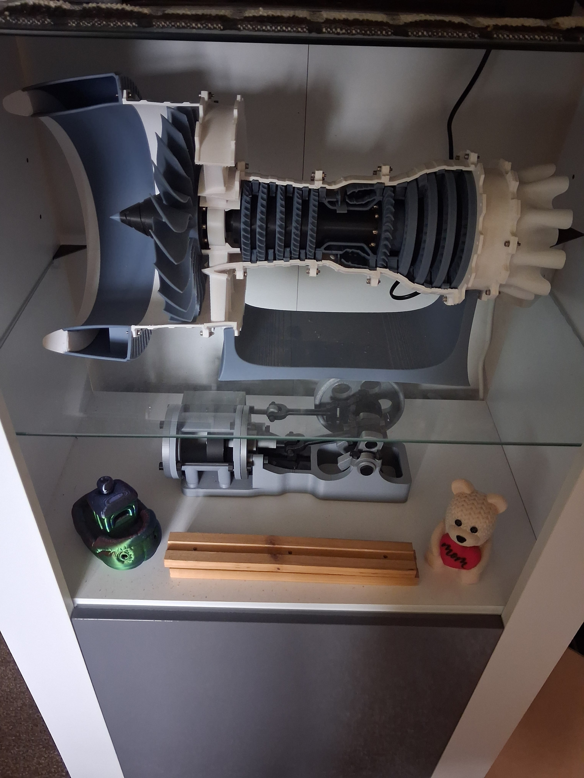

There is a lot of advice to dry most filaments before printing, but how does ambient humidity affect finished prints? As I understand things, printing does not cause a chemical change to the polymer so I would think it is just as hydroscopic after printing as before.
I have a bone pla model getting rain and everything for 12 months. It is perfect.
I have a few models printed in Bambu pla in a home enviroment for two years or so , they are as good now as they was then,
