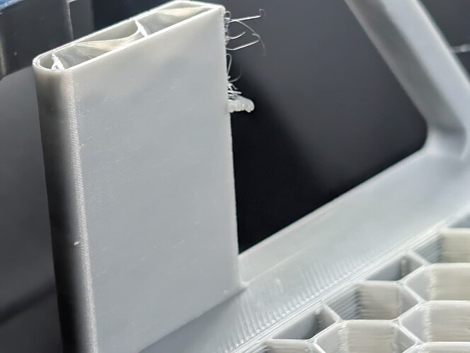

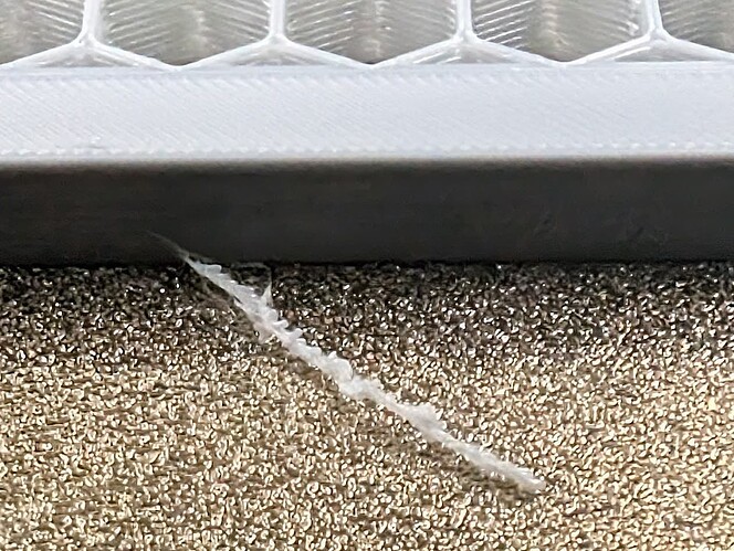

The following is a project I’m working on. I took some bad filament and splice it with other bad filament. I forgot to check if one of the ones was wet, and it turns out to be. But this gives a perfect example of what to look for. As it shows what a dry filament is like even if it brittle and then it starts completely having problems as it goes into the wet filament from the splice.
This is a close look at 1 of the strands. I took it off and a close picture to show the bubbling. This is signs of wetness.
Basically when you see this you need to use a dryer.
