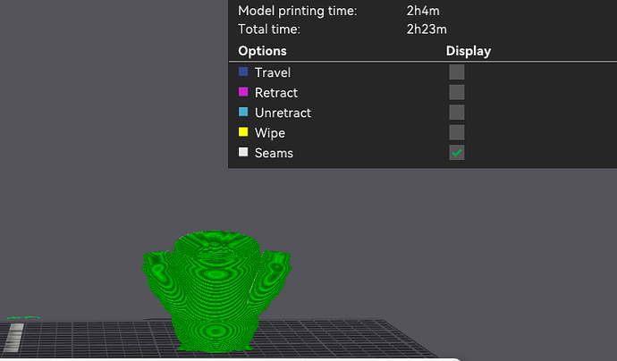

How comes that a print that took yesterday 2 hours to print takes today 5 hours to print?

I did not changed it. The only thing i did was to try a print that took a long time to print.

Has the layer height changed ?
This model is set to 0.16
same model at .20
That would be my guess as well, that’s why I was hinting at…
Most likely scenario, the first one was an STL (at stock .20 layer height) and the next one a 3MF that used .08 or something like that… now using the STL from before the “new” layer height stays at .08 from the last 3MF file instead of .20 and that’s the difference…

I set the diameter to 0,8 and then back to 0,4 and now it takes less time to print.
