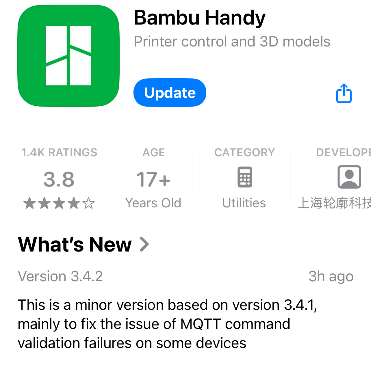

A hotfix has been sent for approval to the appstores.
It should become available soon, to update and solve the problem.
It was found that it only affected some mobile phones.
We appreciate everyone’s patience until the update is available to apply.

Update hit the iOS app stores (updated from the german app store couple of min ago), issue seems to be resolved.
You may need to manually refresh the Appstore for updates, as automatic updates usually take longer to be distributed.
Definitely. You should dispose of it responsibly. I’ll send you my shipping address so you can be confident it is done safely. Glad to help! :wink:
Looks like they pushed an update out a few hours ago:

Just updated the App on IOS and still have the same error sometimes, not all the time but sometimes…
I have updated and whilst the MQTT error has gone away, now I get an error saying more than two sessions are active.
Problem with that is that even my H2D got MQTT validation errors :joy:
The update does not work properly, now getting Invalid Certificate error when trying to connect along with the error about more than 2 devices.
