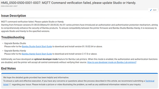

I get this notification of an error message on both studio and handy, since today.
When I looked it up however, the only documentation I can find on it is for the X1 series… I have a P1 printer.
And when I check to update my network plugin or studio or handy or even printer firmware, nothing, no updates.
When I print it randomly shows up, it would randomly dissapear ater im done printing.
How do I get rid of this?

We apologize for this issue.
The error might show because of the lastest Handy app update. Our team has already identified the problem and pushed a fix.
Currently, we are waiting for the apps to be approved by the platforms, so they can be available to install. Usually, this takes a few days.

The update is live on iOS and Android should also become available shortly.
Thank you, which version number has the fixed app version?
Yes…requires a printer shutdown and then a restart with fingers crossed.
3.4.2

As of today,Aug17,2025. They have finally posted the new update. Doesn’t follow the last version numbering though. It’s Ver. 3.5.
