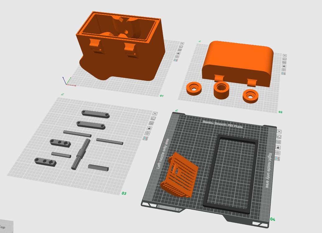

Hi,

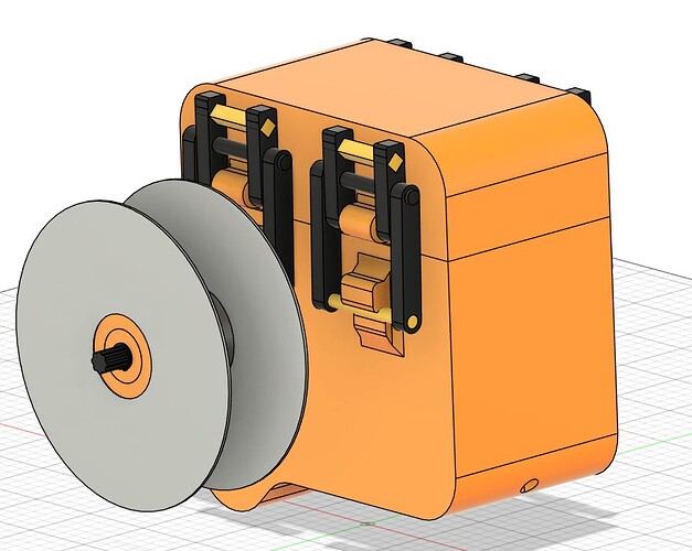

I haven’t received my printer yet, but I have been learning the software. I saw a post that someone would like a TPU holder with bearings, and I’m planning to do a lot of TPU so I designed one (H2D Mounts to be added). I’m planning to share on MakerWorld once I get to print it.

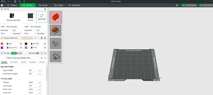

But no matter what I try I cant get multi-plate to work in Bambu Slicer. There must be a setting I’m missing.
Plate.1 always shows red. There are no errors, but no matter what plate I select nothing shows and when I click ‘Slice all’ or ‘Slice Plate’ nothing happens. Does this work if the printer type is set as H2D ? :thinking:
Figured this out. Multi-Plate doesn’t work if you import the items as ‘Parts’ isntead of as separate Objects.
