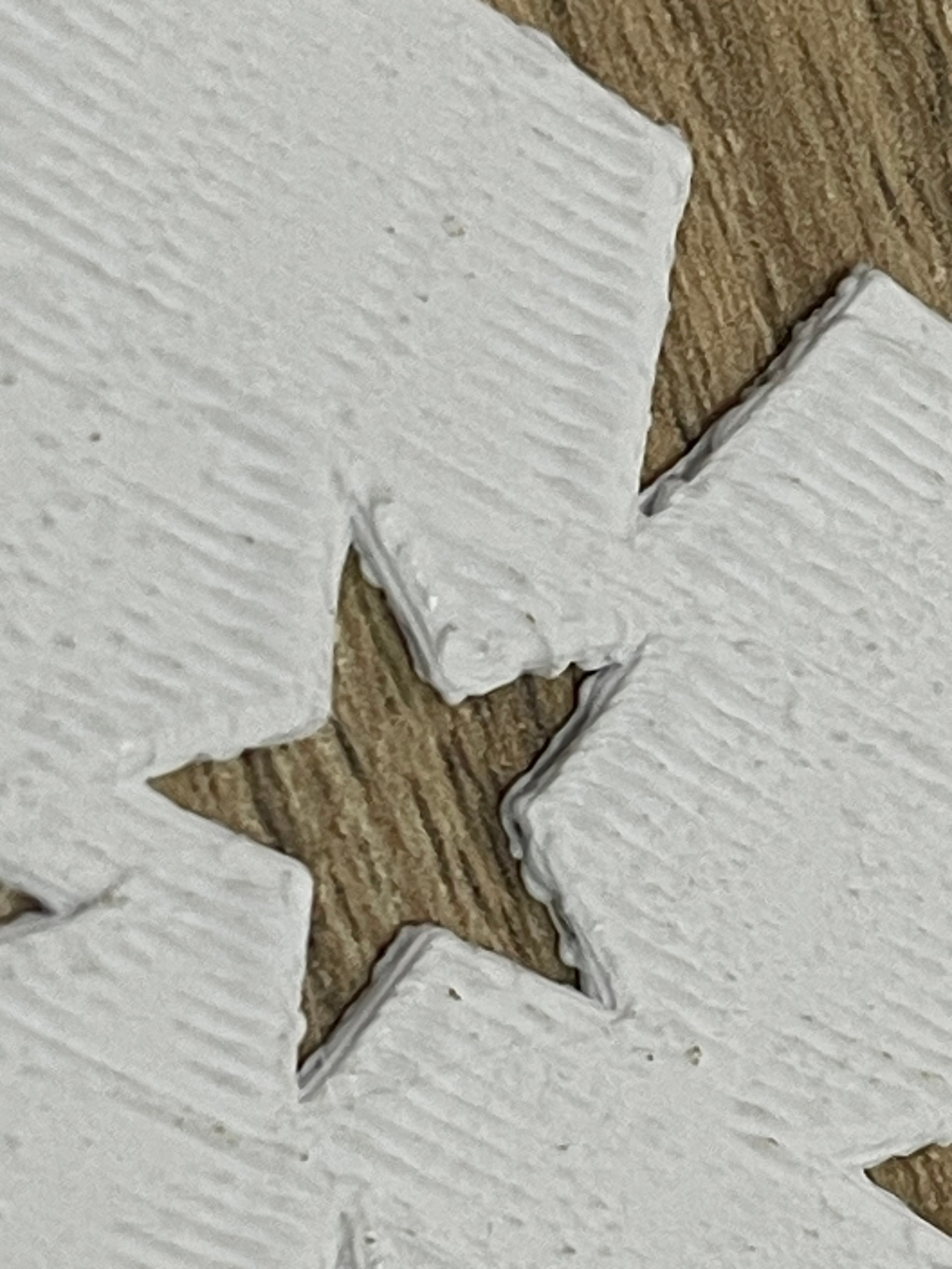

I am facing a similar problem with an A1 with 800 hours of usage. The first layer adheres to the plate, but it is very stringy! It happens with all my filaments (from a Brazilian maker, never had problems before), I just recalibrated and cleaned the plate.
It seems that the extruder flow is not enough and it is printing thin, messy squiggly lines.
Any suggestions on next steps to try?
thanks
This is part of the 1st layer (with the printer running).
When it starts to print the second layer it appears a bit better.
This is the final printed piece, still ragged.
And the last (+Z) layer:
