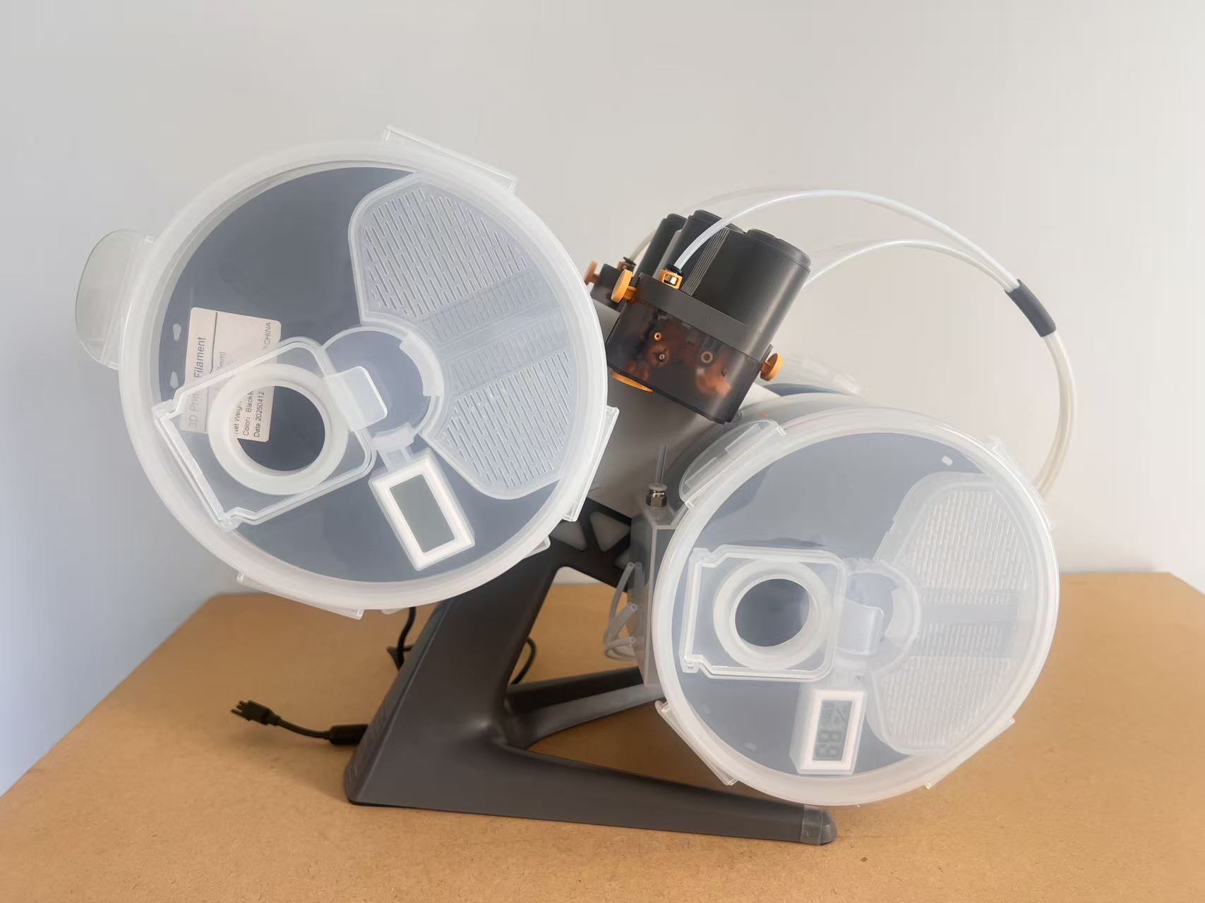

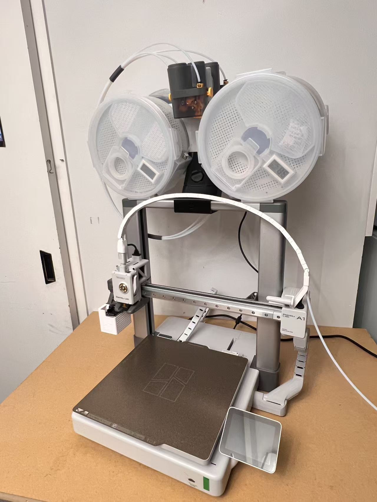

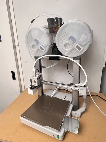

My 4-Spool Sealed Dry Box Solution for AMS Lite

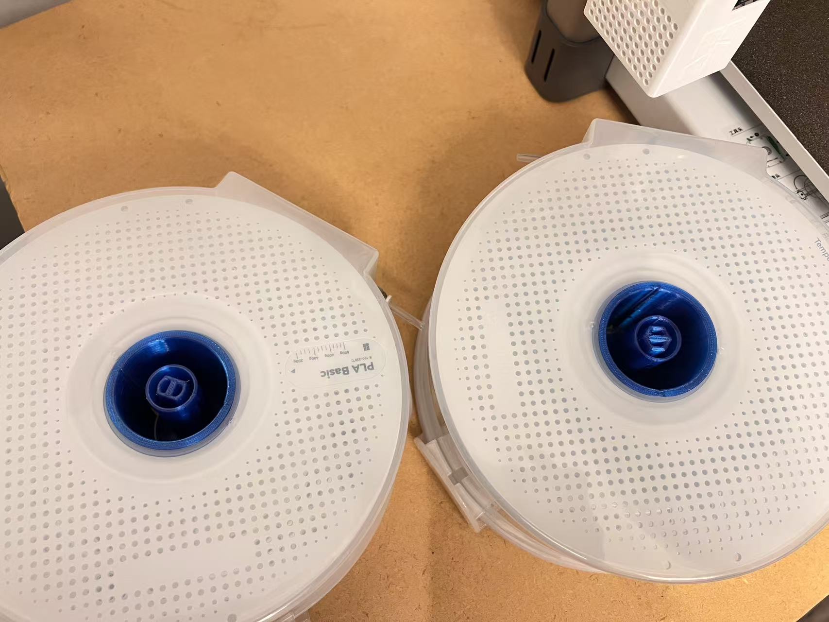

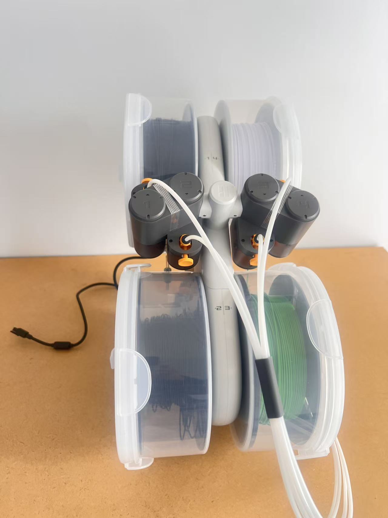

I wanted a better way to keep all four AMS Lite filaments protected from humidity while still keeping the original AMS Lite system easy to use.

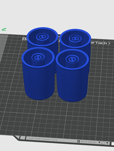

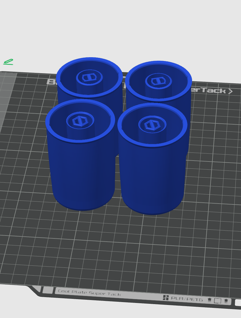

After several rounds of measuring, modelling, prototyping and real-world testing, I built this 4-spool sealed dry box setup.
Each spool has its own individual dry box, hygrometer and desiccant compartment, while the custom adapters mount directly to the AMS Lite without drilling or permanent modification.
The original AMS Lite mechanism remains functional, and each dry box can still be removed individually when changing filament.
After finishing the design, I decided to make the printable adapters open source on MakerWorld so other AMS Lite users can build and improve the system too.
I’d love to hear what other AMS Lite users think, especially how you are currently dealing with filament humidity.
ZEROGAP™ DryDock 4 — Designed by FORMWORKS
Ultimate Sealed Dry Box System | AMS Lite A1 A2L
But what actual dryboxes are those? They look like commercial products but you don’t identify them.
Found the dryboxes:

At first I thought the boxes were his but after going to the model page, it got obvious they were commercial molded polyethylene boxen.
Added - only thing about those poly containers is the limited lifetime on the flap/clamp bits. Cycle those enough and they start cracking and breaking off.

Also, I assume some surgery on them would be necessary to mount them on the Lite but the OP doesn’t go into that, at least as far as I’ve seen.
