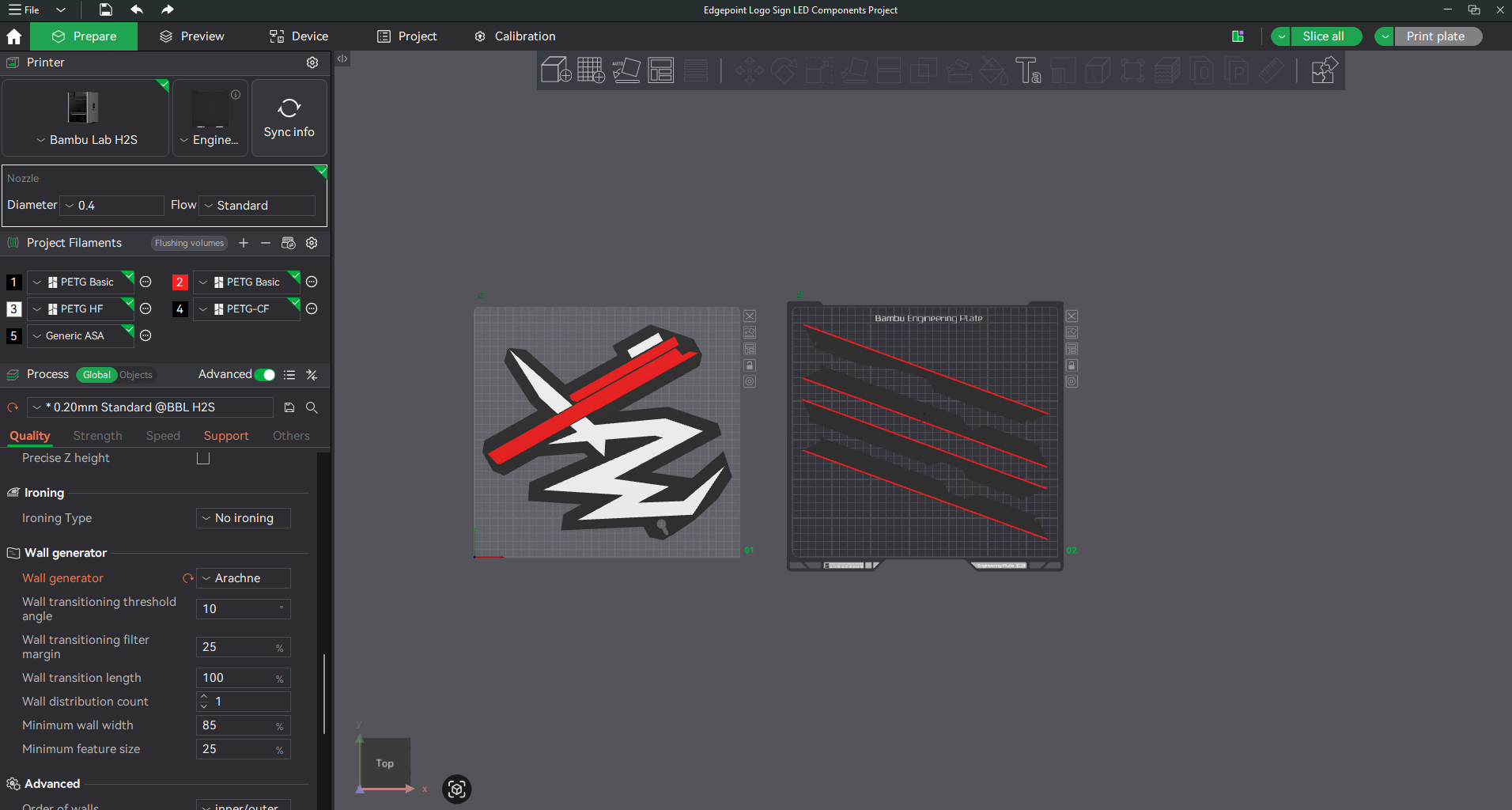

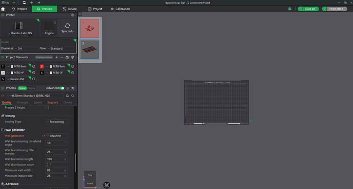

I can’t figure out why my print will not slice. I have it on 2 different plates, and they don’t want to slice. No warning box is coming up as to what is wrong. I’m hoping someone can help me with this.
Edgepoint Logo Sign LED Components Project.3mf (128.9 KB)
Appearances to the contrary, none of the objects are actually “on” a plate, they are all “Outside”.
Select “Edgepoint Logo Sign LED Components”, right-click, and Split>To objects. That should move everything onto a plate.
