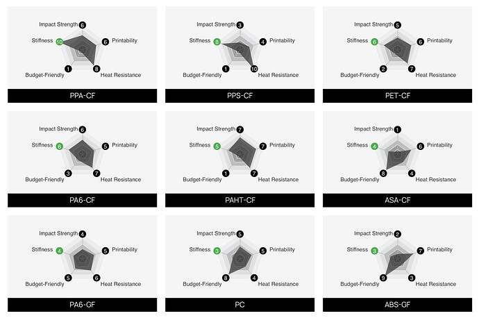

PA6-CF or PAHT-CF will be more stiff than PC. PET-CF, PPS-CF and PPA-CF being progressively more stiff than either of those.
Just curious as to why PPA-CF didn’t make your list. Also, which nylons?
I was surprised that in your spider diagrams, ABS-GF had only a stiffness of 3. Does that seem right?
Thanks for posting the diagrams - it looks like the PAA-CF is the one to beat. It’s a shame they didn’t include PC-CF, as I think it is considered more rigid with less warping than the nylon blends, but apparently not as good as the PPA-CF. Thanks again!
Yikes! Just saw the price of PPA-CF.
PPA is a Nylon so it was redundant to mention it. I usually use PAHT as its AMS compatible and when saturated with moisture from the environment (air) its stronger than PA6. PA6-CF is not AMS compatible and only stronger when dry, PA6-GF is AMS compatible but again its weaker.

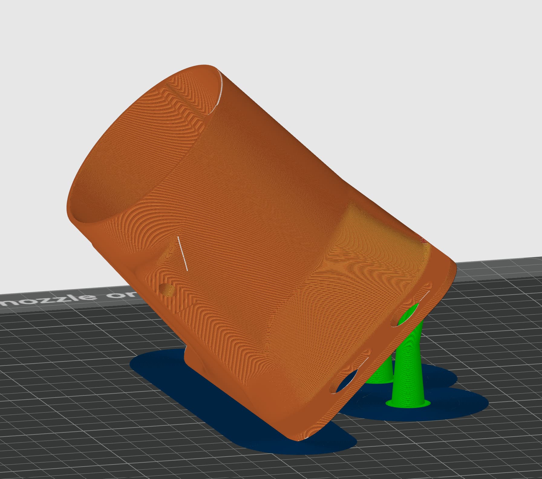

I was thinking of something like this picture.
Not sure this would good for this model but it would interesting to see what happens with the warping. It might be high risk of the whole part coming loose from the build plate?
I imagine with a CF filament you might be OK.

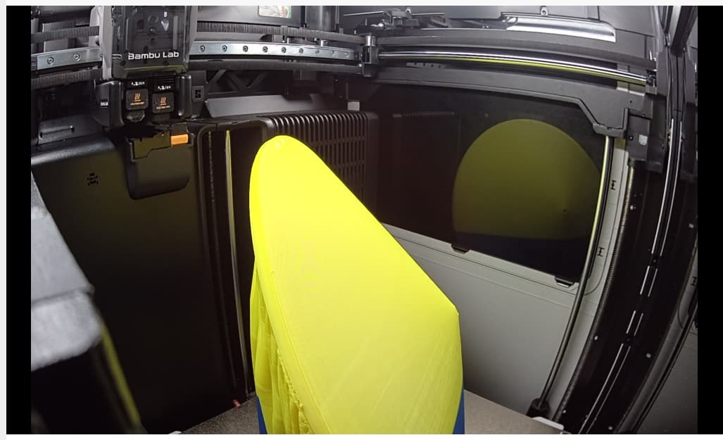

@Pontus_BC I just now did the experiment, creating a huge saucer (roughly 14" in diameter after laying it flat) using a few spools of leftover HS-PETG by tilting it upward 45% in both X and Y, relying on just tree supports to keep it from tipping over, and I saw no warping at all. It may be a crude predictor, but given that result given its extreme size and without any CF, it seems unlikely we’d see any warping with PPS-CF with any tilting we might do with it.
Does that adequately answer your question, or is there more we’d need to test for you to feel confident ?
The test print itself isn’t really a saucer, but rather a bespoke hat I threw together in fusion360 for diverting rain water from dripping directly onto a propane tank, so it actually served a purpose and wasn’t just a huge waste of filament.
