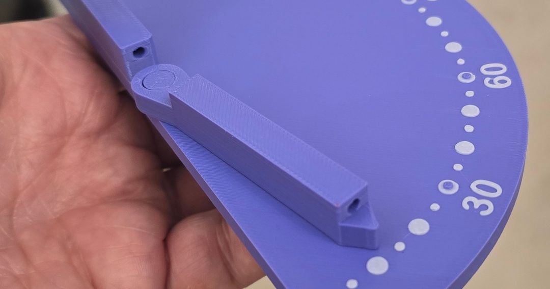

My first time printing Bambulab PPS-CF

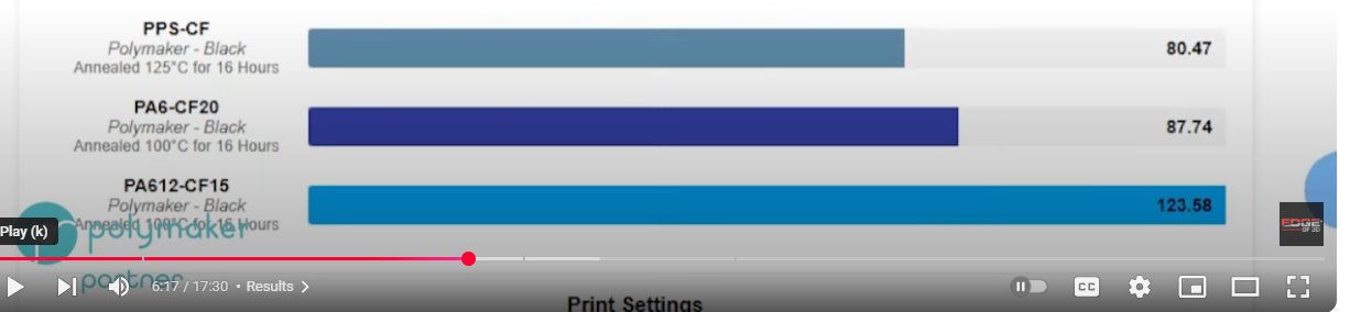

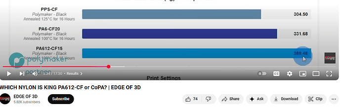

Have you tried out PA612-CF15? This youtuber is pretty hardcore about both testing and comparing filaments, and he’s quite enamored with how good it is (well, according to his own testing that is):
Assuming his measurements are correct, it outperforms PPS-CF by a mile in a lot of key areas. And the good thing is that it’s a lot cheaper than either PPS-CF or PPA-CF:
It’s a bit hard to say here. I don’t understand why PA6 mixed with PA12 would be better than PA12. Let alone PPA and PPS.

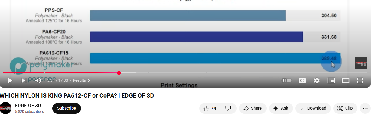

Just now noticed that he very recently did a youtube regarding PPA, and he declares it the Greatest of all Time (g.o.a.t.)
Yes. For the price point, there’s no point of looking at other similar/not as good options.

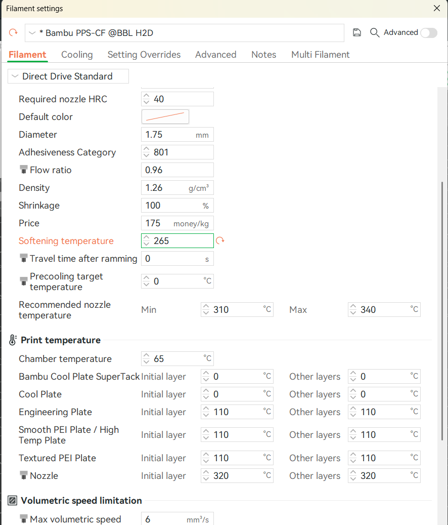

Have you tried changing settings on the filament for minimum temperature and softening temperature?
where do I do that?
252525252525
Under filament profile. For some reason they have softening at 220*. I think the heat deflection is 250-265 for PPS so that 220* seems low. I have no clue if this will help or not. The lowest temp on the filament is already at 310* which should be good.
But those are slicer settings. Does the slicer somehow update the firmware? It’s the firmware that’s doing the loading.
I would definitely report this bug to BL
