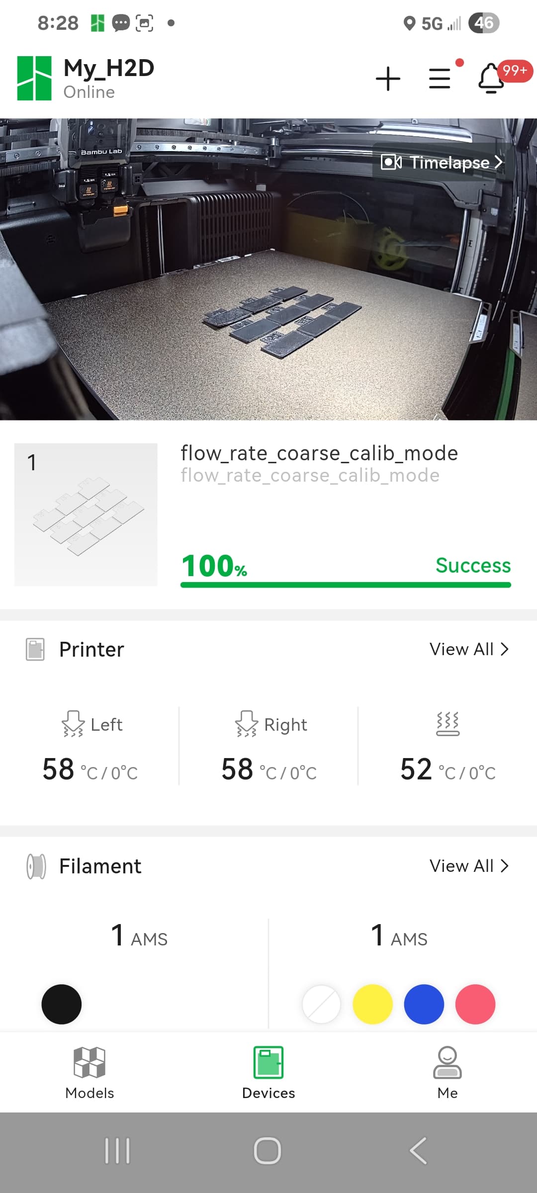

My first time using PPS without CF
I can already tell that shrinkage/warping is going to be an issue…
It’s YXpolyer PPS filament. AFAIK, no fiber. Using generic PPS profile.

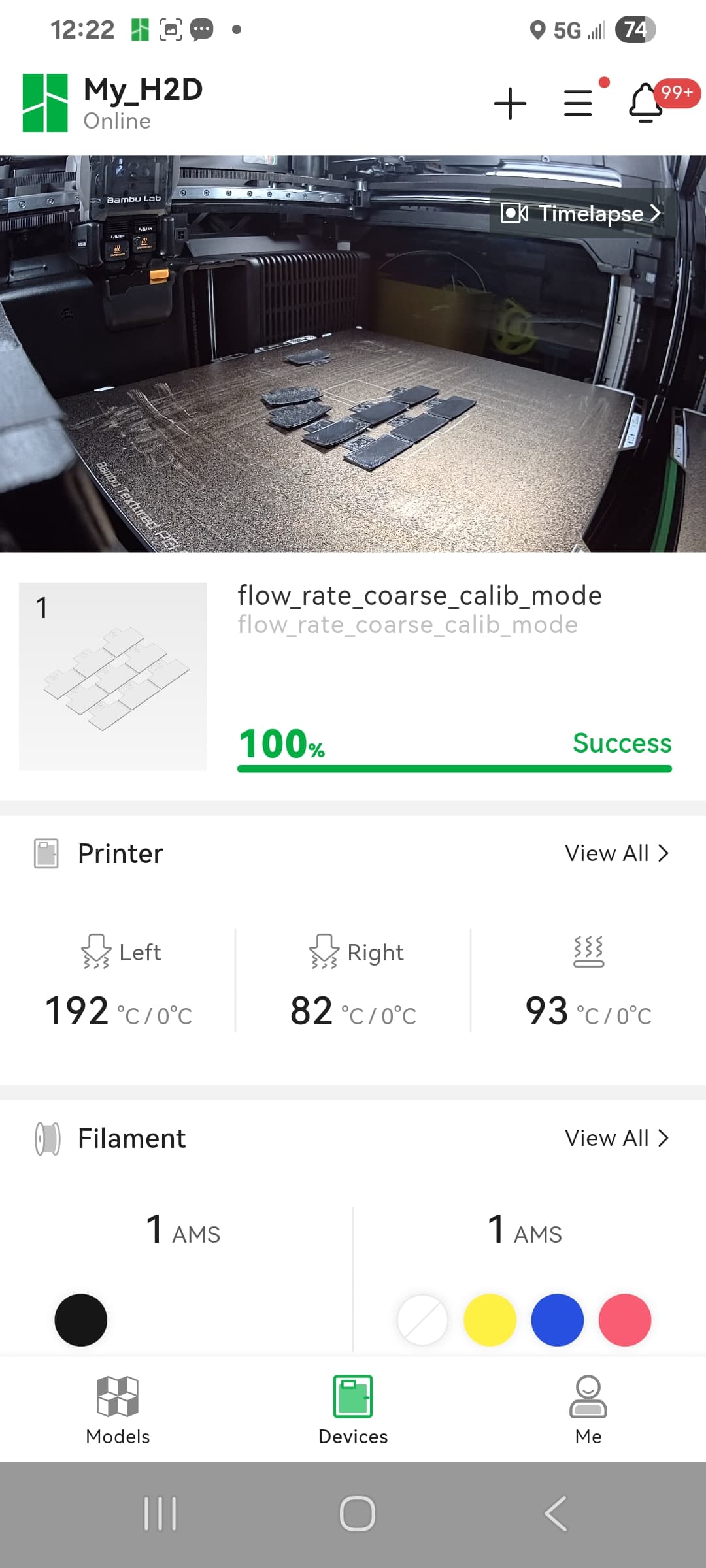

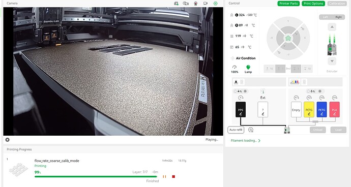

Definite improved adhesion just from increasing chamber temp to 65C and build plate to 120C and avoiding magigoo altogether.
Well, those are just your flow calibration prints. Hopefully it stays that way on higher prints where warp is more prominent.
It’s not sticking very well at all. Unless vision miner can hold it flat, or maybe using some other kind of build plate, it’s going to be useles. :slightly_frowning_face:

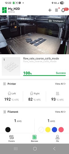

Ok, i guess I’ll need to order a smooth build plate then. This is the result of vision miner on my textured plate:
Still No Bueno!
