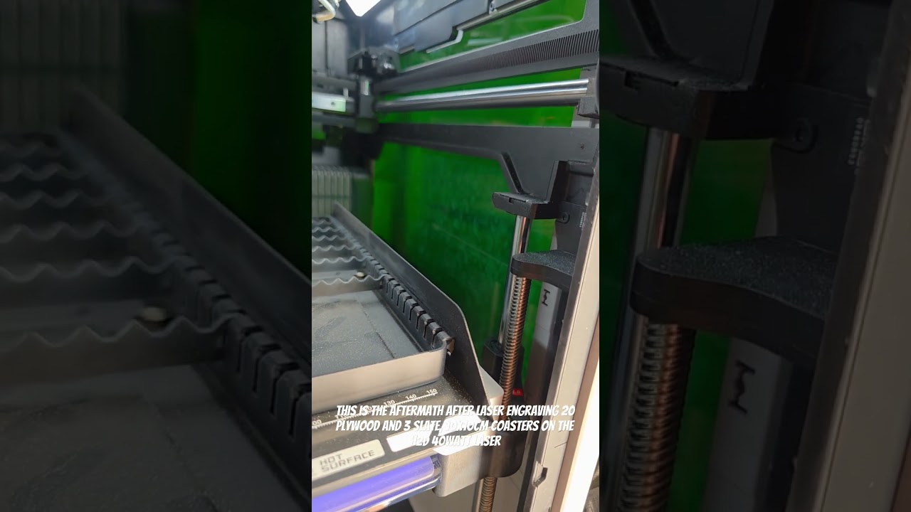

But what about the other hyped feature - actually cutting things to build something with them, like plywood???
As you can see no all is golden in the Bambu advertising world…
While that video shows sort of an extreme it still is valid for even the smallest of laser engraving/cutting jobs…
Bambu utterly failed to address the issue that there enclosure is impossible to clean without taking the entire printer apart.
The airflow handling is clearly not up to the task either as there is more areas where air accumulates fumes and dust on surfaces than transporting them out.
Seriously! What good is a laser in a printer if you are limited to the cleanest possible materials and then still face the impossibility of cleaning the machine properly ?
I rather buy a cheap and much faster desktop laser of same size, do the manual calibration and if in doubt throw the thing out once cleaning it becomes impossible thanks to corrosion from cutting vinyl stickers.

The above video is probably one of the worst cases of ongoing cleaning neglect ever.
On the other hand it shows the problems users will have to fight when using their laser for some real world jobs.

For me it is almost painful to see the video above and to think about the nightmare of turning this printer back to specs.

I don’t even want to know how the inside of a H2D would look like after just 40 engraved and cut coaster or such…
Might be just me though but I can’t wait to see the first video showing how something as filthy as above turns back into a clean printer and how long it takes.
