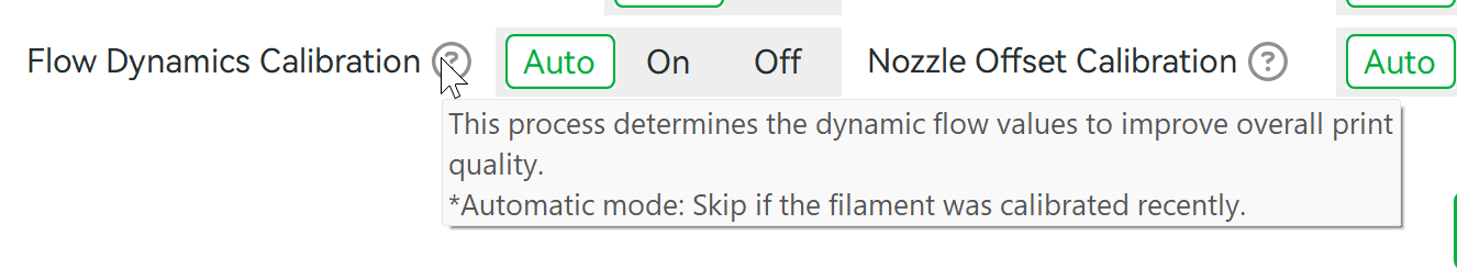

Still, it does the flow dynamics calibration when set to “automatic” even the setting in Bambu Studio is described in a way that it should not do it:
If the printer is turned on all the time there is no way (that I know) that a user can change a filament without the printer knowing.
So according to the description it should not do flow dynamic calibration every time. Need to check it a bit closer but it could be that it only skips it for RFID filament.
Not entirely true. When your external spool reaches the end, and you immediately feed the new filament before it hits the runout sensor, it will not know the filament changed.
When you are running from the AMS and the spool runs out, the AMS will detect the runout, but also here, if you load a new spool in the same position before the runout sensor is triggered, the AMS will push the newly loaded roll against the end of the previously loaded filament. The printer just keeps running and will not pause, giving a smooth transition between 2 rolls of filament.
But you could just as easily loaded a different filament then.
And also other arguments that are given, are probable reasons to double check everything before startup.
But at least you have a workaround for most of the issues.
I think that if you define the K-factor for the filament you use, it might skip the flow dynamics calibration.
But that is something you can easily check.
You can also swap hotends and the printer has no idea.
Yeah, sure, but that (and also what Gerrit wrote) will also apply to RFID filament but with RFID filament everything works as described.
I mean I can always try and force cheating the system but then I have options “Auto”, “On”, “Off”.
And “Auto” only works for me only for RFID filament as described where I can’t see a reason why this should behave differently as this can be “cheated” the same way.

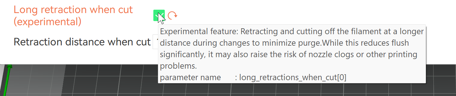

This one could also help reducing waste:
From what I understand this will retract a bit of the filament, then cut, then unload.
What I don’t understand is the warning regarding nozzle clogs or other print problems. Why should that be an issue?
On my Prusa (with MMU3) it onloads it completely, no cutting at all. And in more than a year of using it I had zero nozzle clogs. Why should it cause clogs with a Bambu?
Has anyone of you used the “long retraction when cut” feature already?
For me that sounds absolutely reasonable to leave as little filament as possible in the nozzle/hotend and again, that’s what Prusa always does and it works with zero issues.
