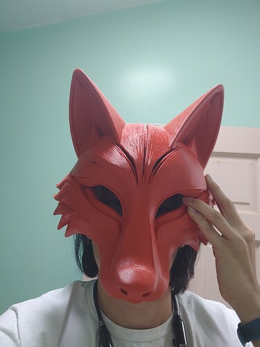

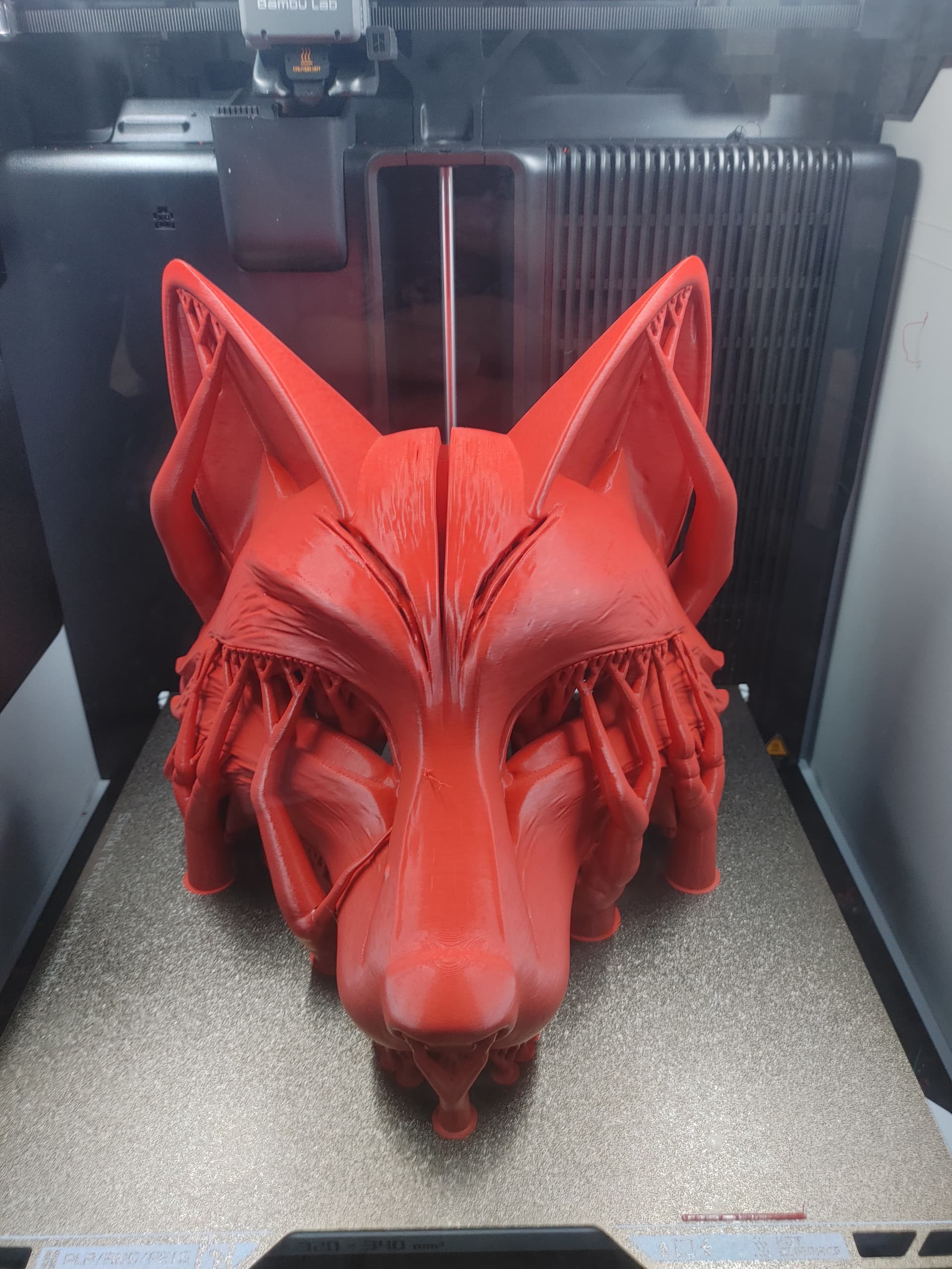

With a 340Ă—320Ă—340 print zone you can print most things without issues. Less need to split into parts.
I saved at least 15g by printing a part in H2S compared to printing in X1C [Where It would have needed 2 prints, and more walls at the split zone].

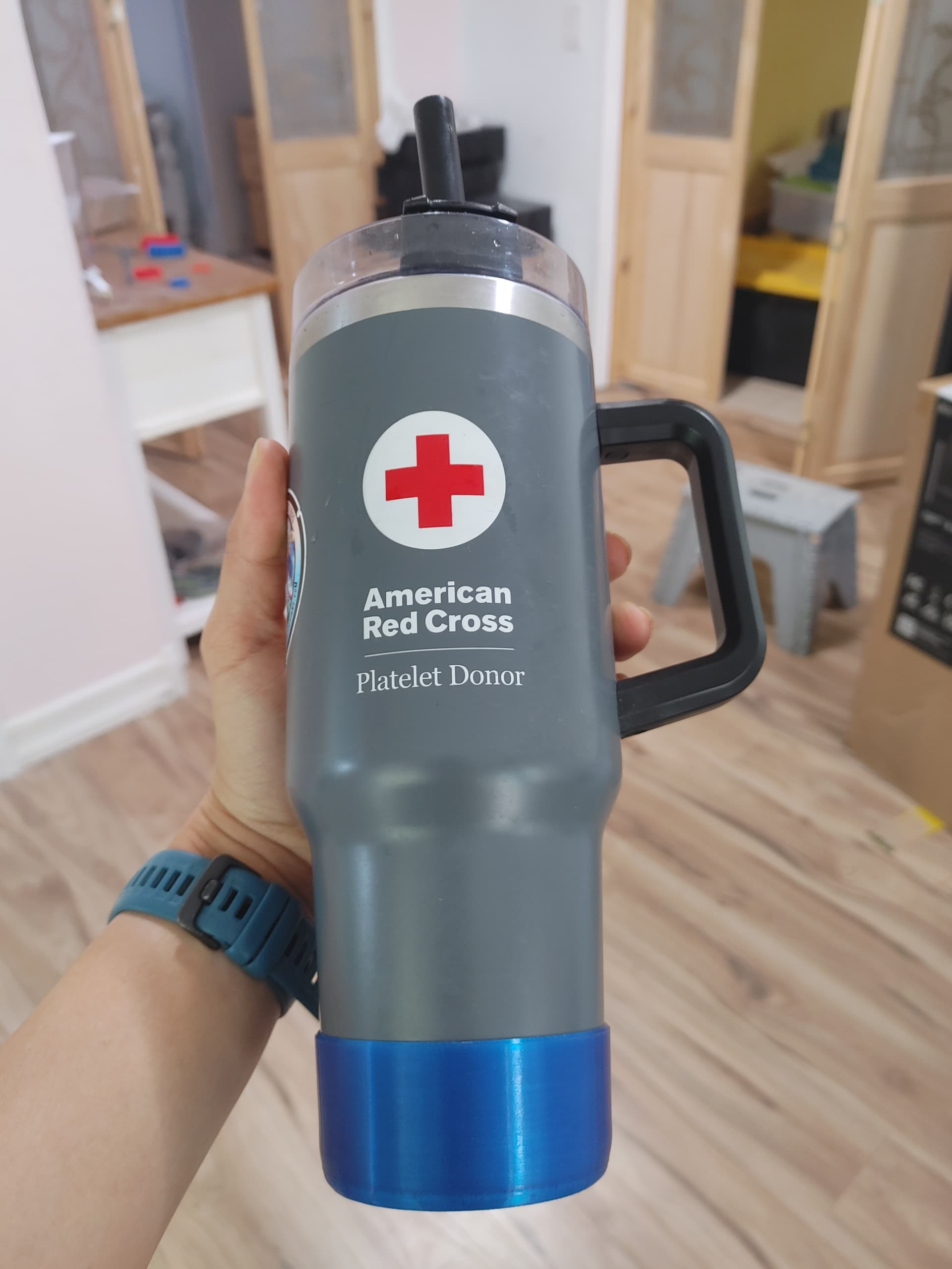

It useful for both functional prints [see the tumbler accessory] and fun prints
