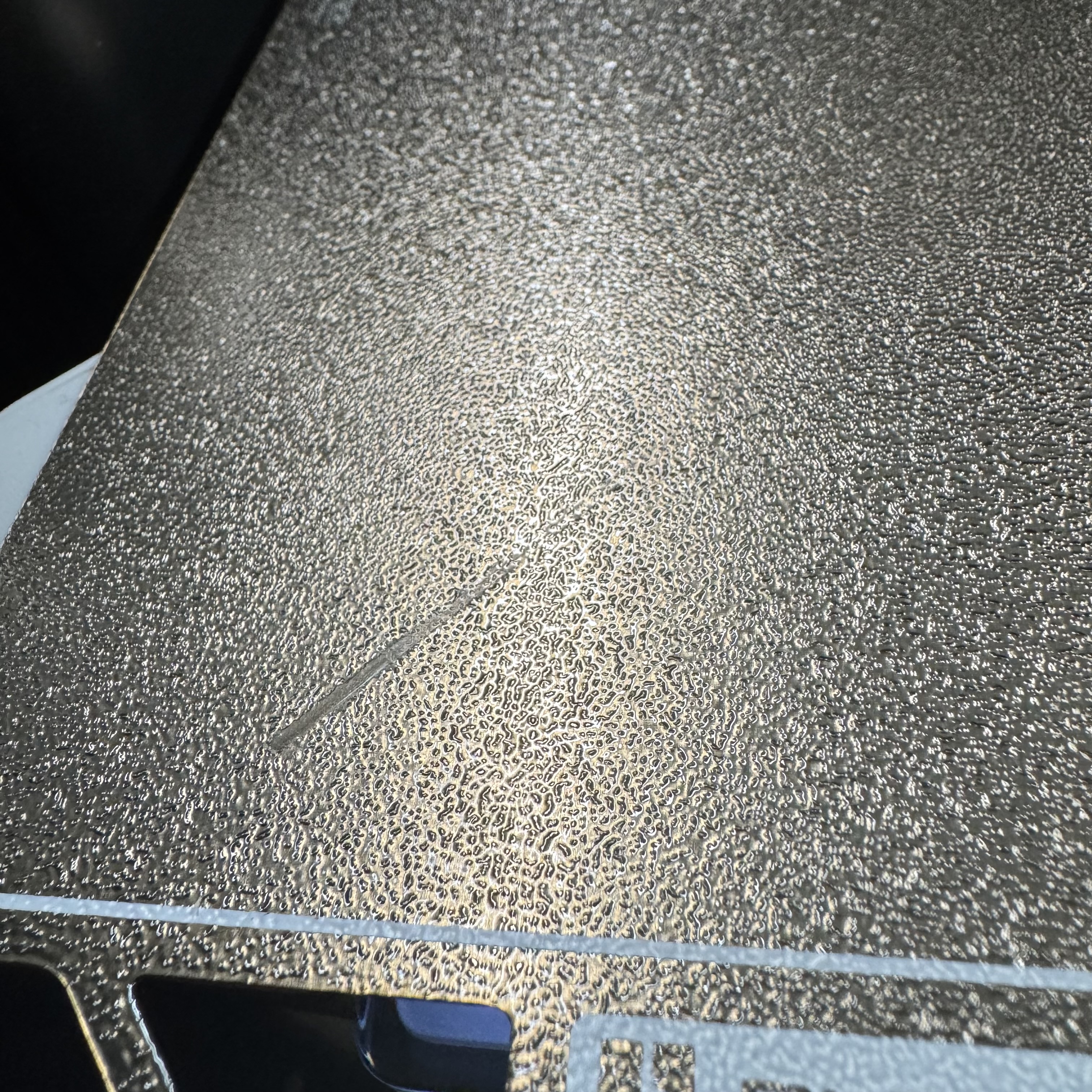

  • First thing I noticed; build plate has a scratch in it. After I did the calibrations I noticed the scratch begins exactly where the print head probes. Could this have been a test that scraped the plate?

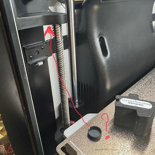

  • Next issue; a rubber piece fell off when I pulled out the foam on the left z screw. I think it goes inside on top of the screw?

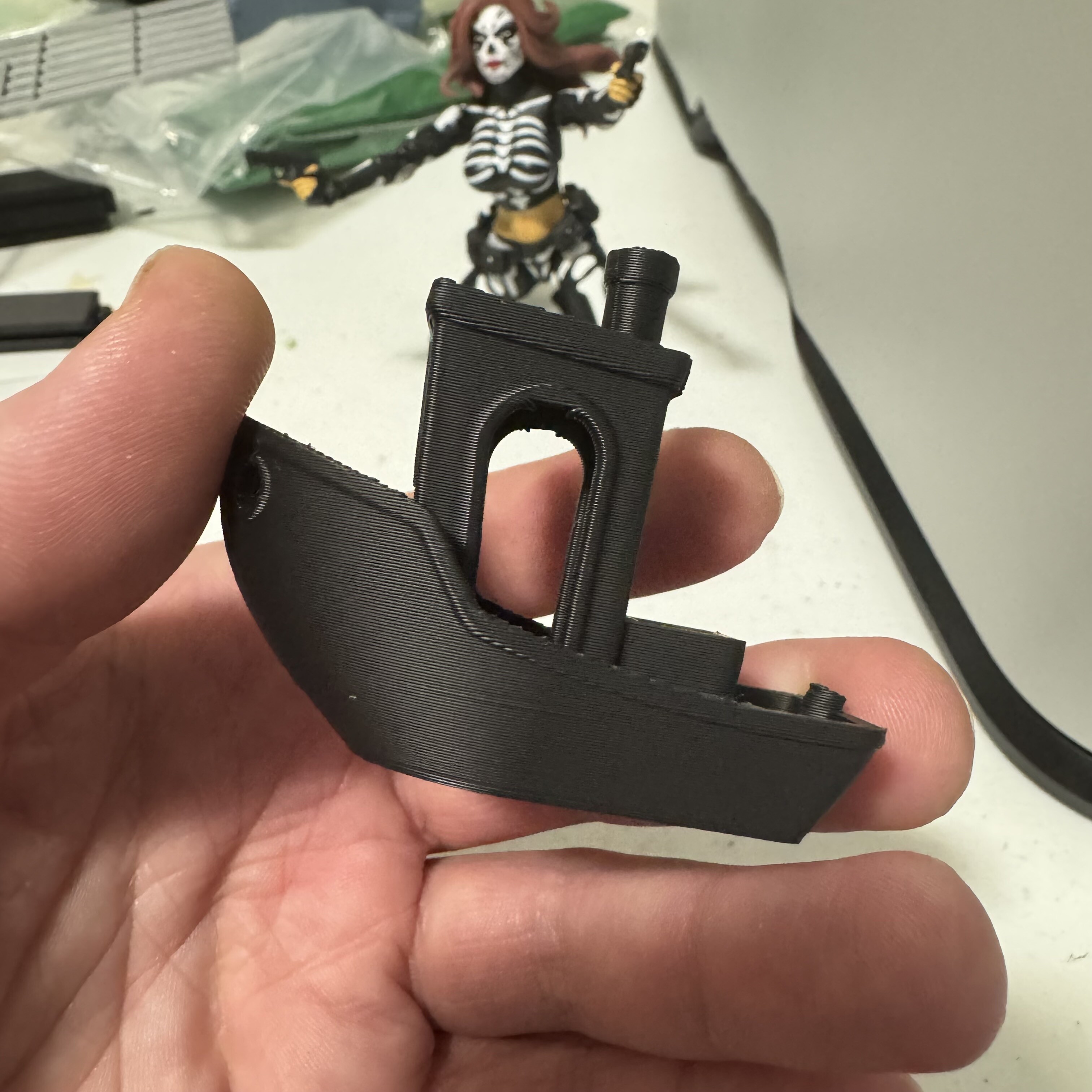

  • Speed Race 23m Benchy printed the best looking 20m benchy I ever seen.
  • Printed a few 2-color propellers which came out as great or better than my P1S which prints as good as brand new with over 2000h.

My printer is printing a part, but I don’t see that cap yet. It’s possible it was just left in the printer during production they sometimes include caps and plugs in parts. I recommend contacting support, as they should have a parts list showing everything part that is used in the H2D.
Cool propellers :+1: and enjoy your new printer :grinning:

Yes that rubber piece goes ontop of the lead screw under the plastic.
[edit] Thanks. I was able to get it back in there by loosening 2 screws for the camera housing which also holds the lead screw and put it back in there.
I also just noticed that the build plate is also scratched in the exact same way on the back side.
