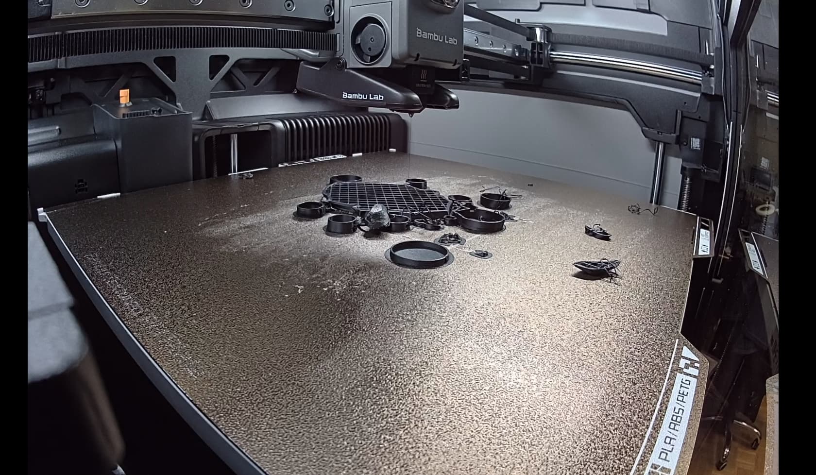

My new H2S can not use it
I have now tried to print for 4 times and everytime it pull of something already printed or it just break it off with nozzle. I have cleaned heatbed plate totally, and was the same now I use bambulab glue also the same I also calibrated printer and it is the same. What can be wrong here?
Nevermind, the label for filament fells off and it was ABS not PLA as I thought it was. So I think that was the problem. Now I am printing with PLA and wait to see.

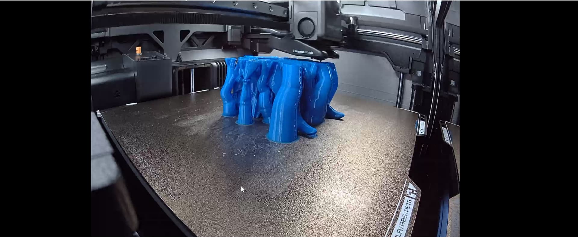

Also check to see if the infill pattern is set to “grid” if so change it too rectilinear. Grid creates issues.
thank you for advice. I never changed that. I will now.
Printing is still going on and it looks good.
