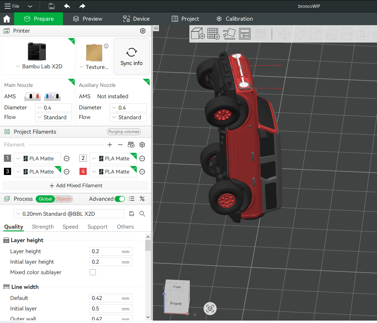

So I tried to make my own content. Goal: make a small 3d 4-door bronco. I loaded in a pic of a bronco into Bambu MakerLab, after paying 2 credits to Export it, I spent many many hours cleaning up the coloring inside Bambu. I selected slice and after a while I ended up with something that looks like it came out of Stranger Things’ Upsidedown. What did I do wrong and how can I do this better? All help and suggestions greatly appreciated. (Yes there is a bronco inside there, it is with the spare tire on plate and head lights at positive z).
FWIW…this is in Prepare mode before the support attack.
Are you referring to the supports surrounding the model?
Yes, it seems kind of excessive or is that normal? Is there something I can do to reduce them? The Bronco is pretty close to a rectangle, why the need for so much support?
Probably normal but you may have better luck changing the angle of the model. What are the 2 red lines coming from the fenders, are those trail markers, if so they may be hard to get them to print.

Lol, yes they are trail markers. I tried to remove them but got frustrated because I couldn’t get a cylinder to stay up in the air to slice them off, so I figure I would just let them print and I would cut them off if they even would print. I am sure I need to hit a YouTube to understand how to remove a piece that isnt touching the plate. I just was concerned that all these supports is because I didnt know to do something like click the foobar button to reduce resolution or some easy fix it button.
If you tilt it to a 45 degree angle or so you can get more of the supports on the bottom and less on top.

Ok yes I put it on a 45 and much less on top. I might try to print it…any prediction on what the printer will do for the trail markers now at a 45? Will it just skip printing them since they are so thin there are no supports for them?

I dont think you are getting those trailmarkers, they are smaller than the printer can do. I kinda think its going to skip them but I dont know.

@Rusty35 w.r t. The trail markers…perfect, didnt want them anyway. I had noticed when trying to print Ford valve stem caps that the Ford was too small for the 0.4mm head. I just ordered a 0.2mm…will hope it will print the Ford logo with the smaller head.
